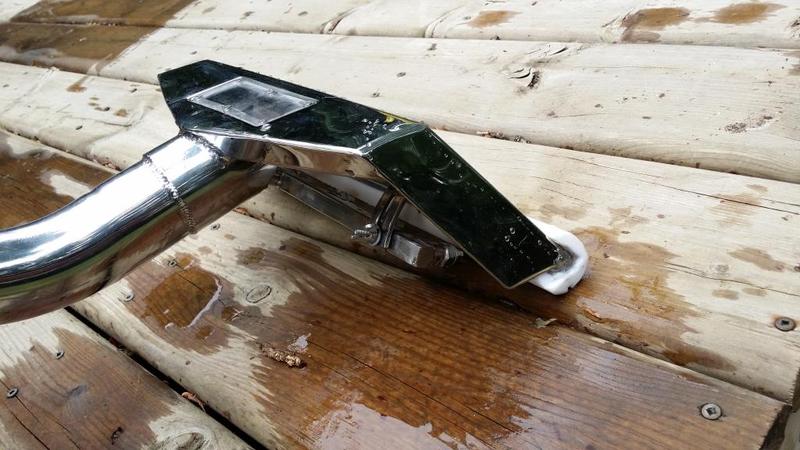

Ron the AW29 is a 1.5 version of this wand. It's jets strike about an inch further back
Not much of a reason for a side by side.
No it's not!! The AW29 is a totally different wand made by a different manufacturer. The new and the old 802 is the EXACT SAME head just the new has a 2" tube standard and the old it was optional and rarely ordered. The jets are the same, the angles the same. The new has the screw lips that they use on the 12" PMF titanium wand and a set of glides. The 802 and the AW29 are both old standards. Make them 2" tubed and you get better lift and airflow at the wand, add a glide, theirs or our's and you will improve the ergonomics and performance again.
If you want to test sheer angle and it's effectiveness, get a real Greenhorn wand and a stock CMP 14" low profile wand with 2" tube (the base we built the Greenhorn wand on). Stock the wand had straight jets, the Greenhorn angled them. try them each with high, normal and low flow jets, different PSI and with and without glides.

I don't like "shear kits"
I took Greenies mess off my
The Myteemafia sheer design and Joe's are all the same imo.
01, 1.5 and 02 jets put out a mist that deflects off the carpet too much. I prefer 03 or 04 jets that have bigger droplets that pierce the pile and FLUSH

I agree with you on the jets. I think the 03's are the sweet spot. That larger water droplet carries more impact and more heat.
Side by side however, angled jets and a glide will out clean and leave a carpet dryer than the straight down jets.

I finally took the plunge and tried 5x 03 jets. Absolutely love the cleaning performance now
Having an adjustable shear I like it best from the middle setting to full angled sheer personally

did you cut in that window yourself? What thickness and type of plastic did you use?

I like My PC Ti it has a slight sheer to it, I've have used several sheer kits PC quad and even the rotary dry master is using a sheering action to clean.
I wasn't happy with either!
I think if you want faster dry times go with more sheer your not flushing better the water is pulled back out so fast, that can leave soil.
Increasing flow on the sheer can help but at what cost using 3x the water?
Thats why people say remove the restrictor on the drimaster rotary and increase the PSI, you'll fill your waste tank after 3 rooms but who cares.
A 6 flow quad without sheer with a slotted glide or without a glide will lift the pile
and clean great.
I do like the sheer on the zipper but the jets leave distortion on a thick pile.
probably why its more of a commercial tool.

Ron, This wand was originally a Venus. Got the new vt head which comes this way now. I did have the shear kit on the previous head as well.
