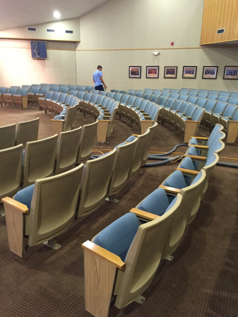

Will someone post some links to some of the brushes and tools you are talking about? I wonder if I could ever talk the school into letting me clean the chairs in the auditorium. (Small School, like 350 students, 7-12 grade)
Reactions: windycitysteam
Thanks for the video Rick!
I think that's great for freshening up light soiled upholstery. Auditoriums would be a prime example.

i think that is the wrong way to clean. all you are doing is pushing the dirt into the fabric not out of it. and a damp towel picks up dirt better than a dry towel. I wouldn't show that video to any one that i was trying to get work from. talk about hacking, hell if its so lightly soiled then put some flex ICE in a portable and do a super fast clean. don't need to stay in the 1970's with all the upholstery cleaning tools available for us today.
at least a von schrader machine vacuums up the foam, if you need to clean at least use a water bottle spray and a wet vac to "rinse" with. a little more money and you could use a small extractor with SS uphol tool and a rinse solution in the tank. encap prespray if you like but get the dirt out.
9,611
Hawaii
i think that is the wrong way to clean. all you are doing is pushing the dirt into the fabric not out of it. and a damp towel picks up dirt better than a dry towel. I wouldn't show that video to any one that i was trying to get work from. talk about hacking, hell if its so lightly soiled then put some flex rinse in a portable and do a super fast clean. don't need to stay in the 1970's with all the upholstery cleaning tools available for us today.
Why extract it if it's lightly soiled? Unless people sit on it butt naked, there clothes will "extract" some soil off........:lol:
encapman
2,349
St Petersburg, FL
Rick Gelinas
Some of the soil is wiped up with the final step. And as Nate correctly mentioned, the little bit of what's left will be removed via their clothes.
Of course at this point we can get all mushy about this and say it's not as clean as clean can be. And you know what, you'd be right. But there are situations where it is a practical approach to upholstery maintenance. Consider a couple of scenarios.
1. Some jobs have lightly soiled chairs and a light cleaning is adequate for their needs. Why bring a bulldozer when a shovel's all that's needed.
2. Many facilities only want to pay peanuts for upholstery cleaning (for whatever reason - budget constraints or they're just tightwads). And in that case this method makes sense too. Sometimes you have to cut the cloth to fit the garment (to borrow an old tailor's expression).
Keep in mind guys... Upholstery is flat. We're not dealing with plush carpet pile. We simply need to displace the soil that's on the surface of the chair. And that doesn't require a fire hydrant. :winky:
I agree those are the key points. Light soiling can effectively be cleaned that way. When it comes to appearance management even on a low budget they get a major improvement.
I like it for fabrics that can be problematic with drying issues, like color bleeding or browning. It looks good and the appearance is safely improved.
Heavier soiling or contamination I'd push much harder towards HWE but ultimately its their upholstery. We will give them our suggestions and let them make educated decisions.
