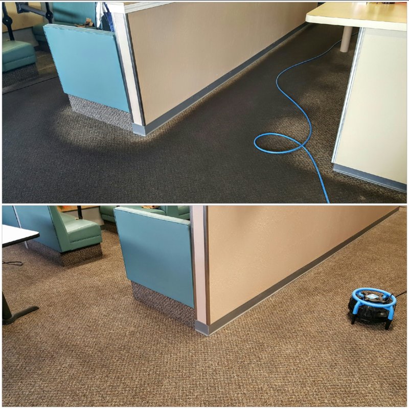

117,061
Only me?
Who the heck do you think will be buying these things once word gets out. If Tom is smart he'll have it hooked to my truck in Vegas the whole time
RAGE owners are going to go nuts
Oh and suck it Sutley...
Tom's wand is going to put a ding on the 47 and 48 truckmount sales
Even though it will hurt my heat I think I'll try mine with 8 flow
I'll call it my Ron-Co Shortcut wand.
(Tom bring extra jets, 4, 6 and 8 flow)

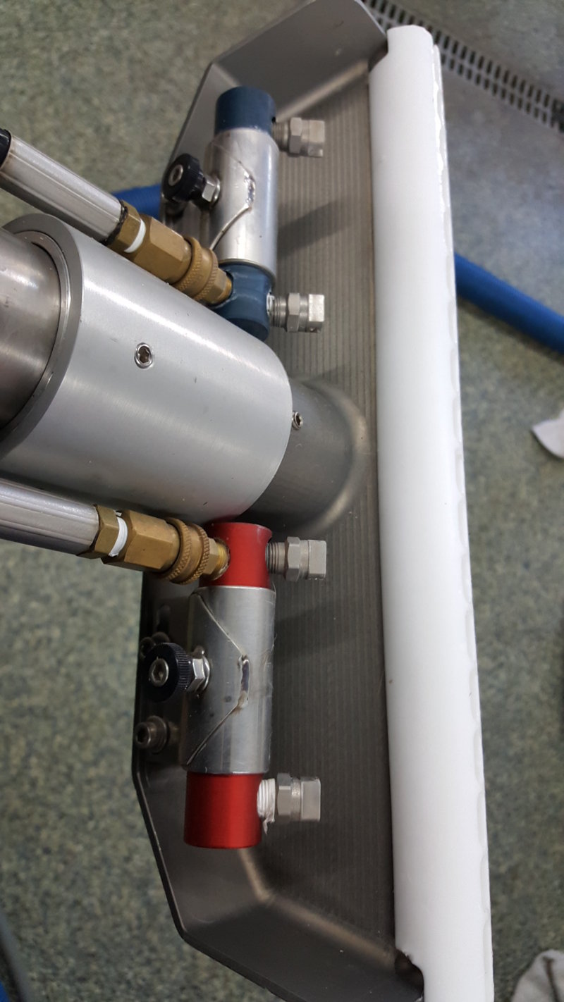

11,200
I might still try going 9503 on the outsides and 1103 on the inside for a 12 flow again and see what I get.
The 8 flow is good....I just wonder about the impact of a 12 flow too....
Easy to switch out the jets on the extra manifolds I have to try it....
