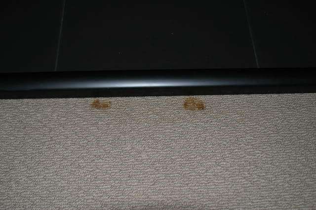

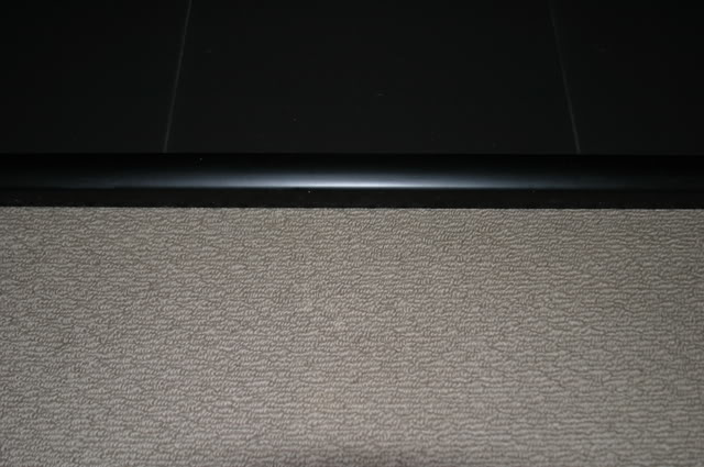

I 'pre quoted' this job as it was an out of town job at $300.
After I saved it, the assessor told me he was facing a $15,000 replacement claim :shock:
Only took 25 minutes on site and 40 minutes travel each way so just over the $100/hr from my shop return.

They're burns Albert, little point in trying to 'clean' them.
On wool, sometimes minor areas can effectively be scraped or the small bits of ash broken away with vacuum and look ok, but rare to get an area like that to clean that way.
Also, even if in doubt, repair work is way better and easier dry.

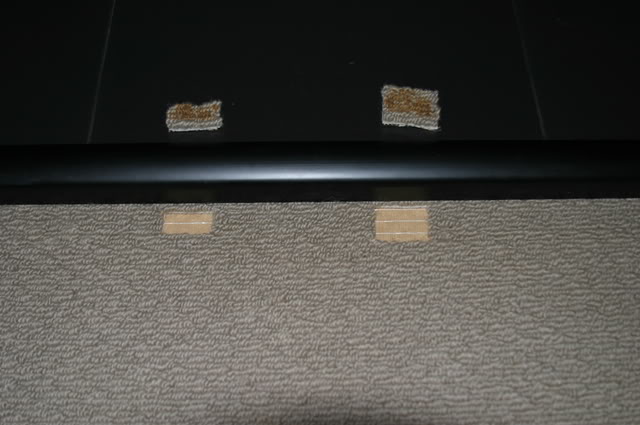

Heathrow said:
BTW - was the pattern easy to match up? I see a lot of that carpet.
Sorry, Heath, I missed your question earlier.

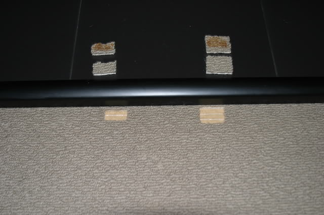

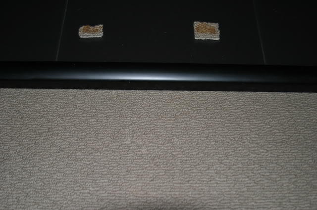

These styles are very easy to match up. Because of the varying height, you just count up/down from a given point on both to line them up. I will sometime try and make my cut start at the low point on my primary corner where everything gets calculated from. Then it's a simple matter of finding the lay of the donor, cutting the width of your piece and then finding the same low loop to cut beside for the first cut, sitting it in place or placing the old piece on top to get the same length and make the final cut. Usually nil trimming on these, just stright in.
Free hand baby :mrgreen: Some get sick of me saying that but it's the honest truth. Guys like Craig have also mastered this and I firmly believe it makes for a better and quicker and neater repair. At least when this small anyway.
