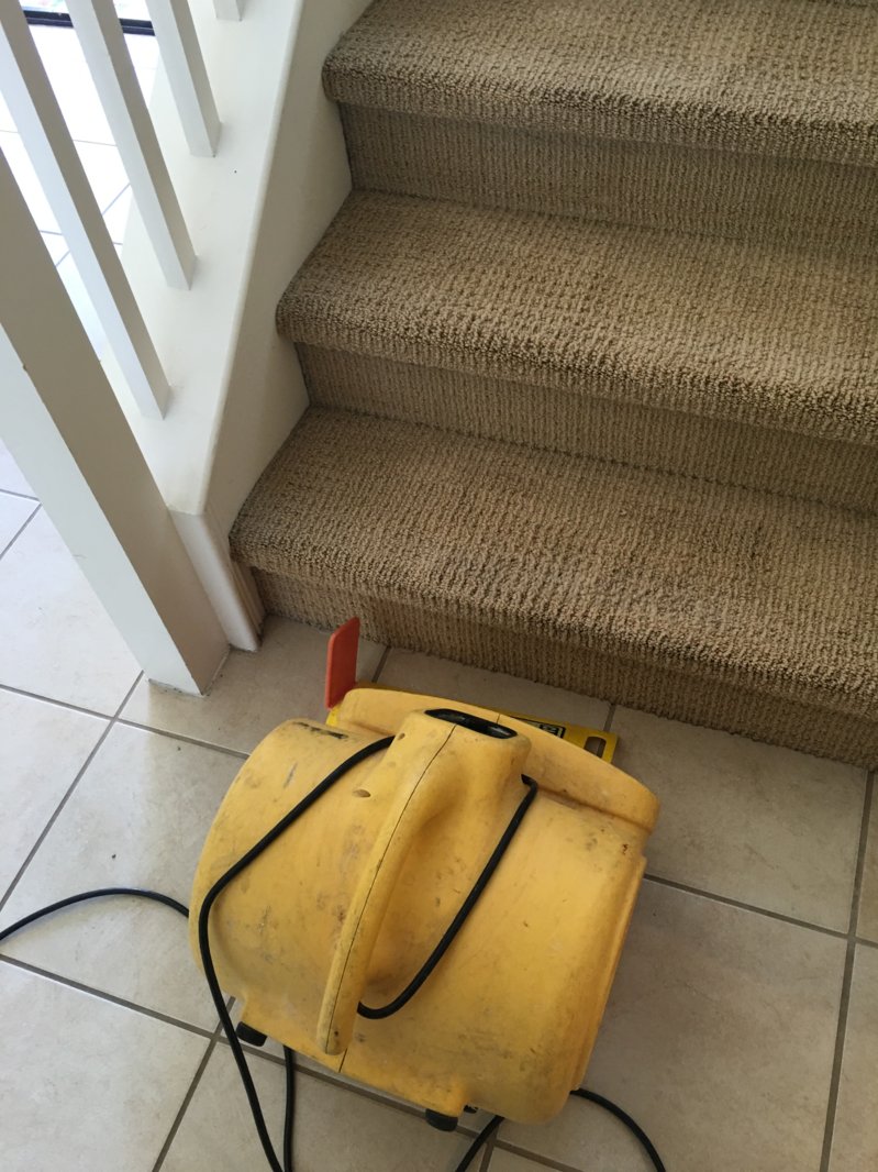

What pressure are you using on the stairs? I usually turn mine down to 200 PSI as I: have a ProChem single jet tool. I also place an air mover at the bottom of the stairs as I finish up the rest of the job.

Air mover would be nice but I always leave the steps for the last so that my pre spray has the entire job to dwell. so it wouldn't get the air time that the other rooms get with my fan.

I know wipe down the blower
