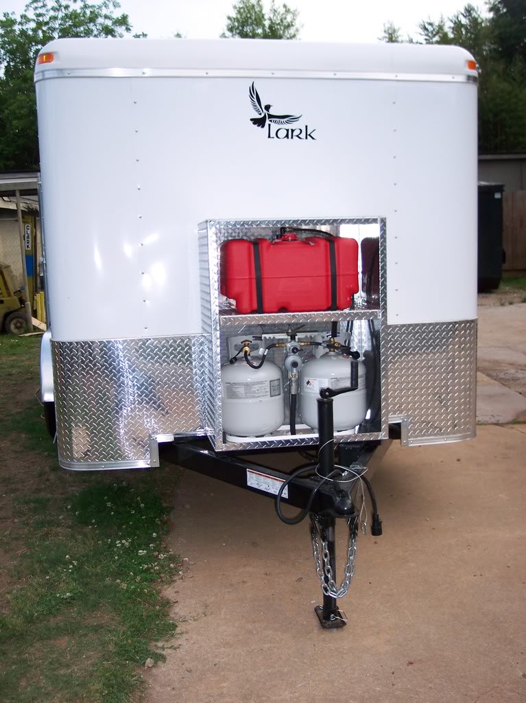

This is a 12 gallon boat gas tank, and 2- 20 lbs lp tanks for a camper.

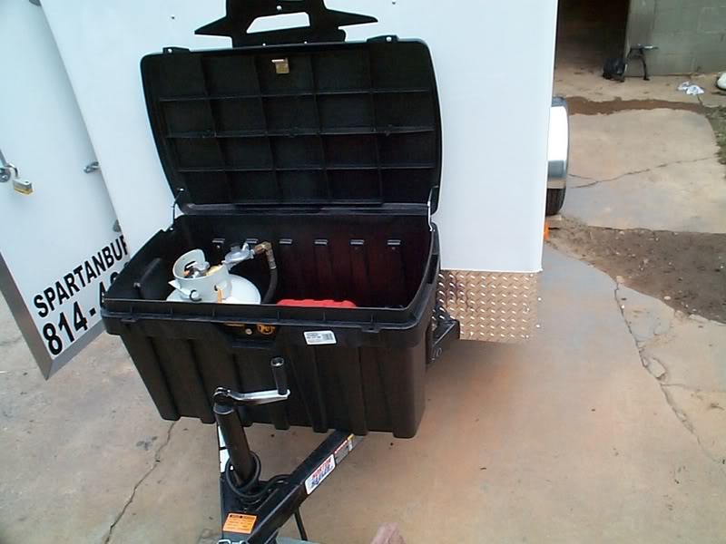

I just looked at this website that Shane posted. The prices are very good. I would order my LP system from them. Then I would go to a boat shop and get a twelve gallon boat tank from them. I normally mount the system on angle iron and have the propane bottles and gas tank side by side across the front of the trailer. I will look and see if i have photographs of that. Also, another neat way of doing it is this: Lowes has a big black storage box that you can mount on the tongue and put the boat gas tank and one 20 lb. LP bottle inside it.

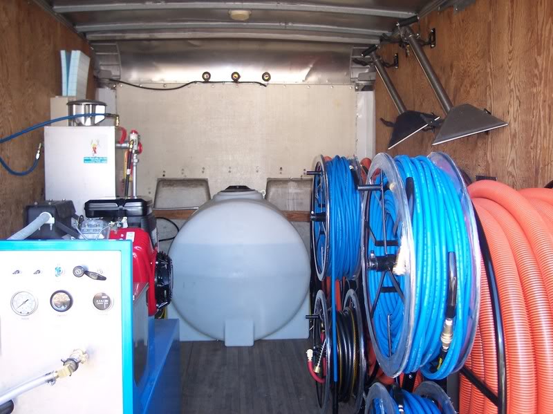

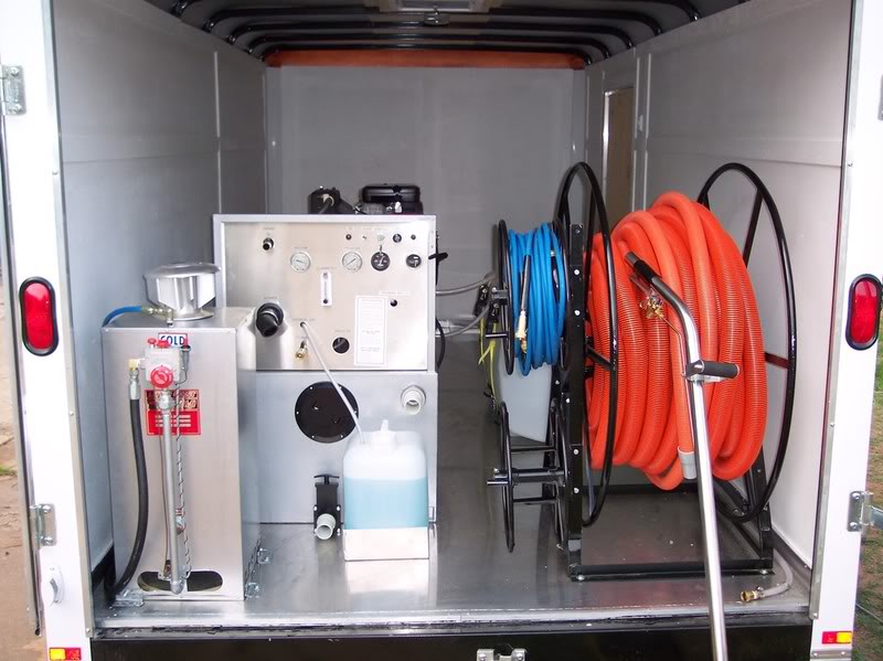

Steve,

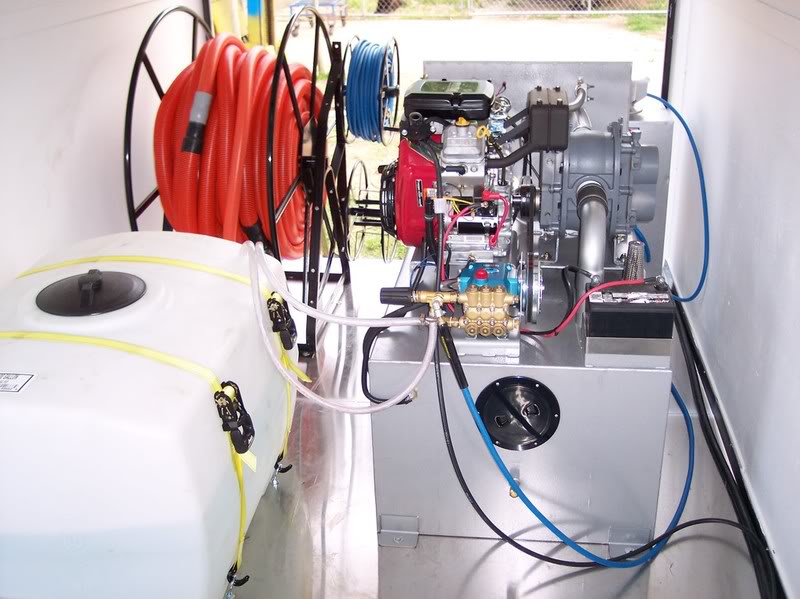

The reason that the truclkmount is installed in the trailer the way it is, is when installing a unit in a trailer, it is recommended not to have more than 200 pounds tongue weight. As you can see in the photos, it has a 200 gallon water tank weighing roughly 1600 pounds, plus the large recovery tank capacity of a 120 gallons of a TNT, adding an additional roughly 900 pounds when full. I mount machines in a lot of different configurations. Sometimes guys want to carry a roll of carpet, so I'll move the machine to the front or the reel to the front to give room for the carpet roll. It just depends on how much weight we have to redistribute.

Steve, around 200 pounds is what I always do. It just makes it tow better because it doesn't require the vehicle to have air shocks or load springs added to level the vehicle. I've installed a lot of trailers with a lot of differnt configurations. Ths particular install in this phot is a long trailer. I think it was a 16 foot trailer. There is a ton of room in the front of it. You just can't tell in the photograph.

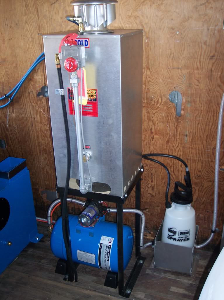

I noticed you have a small blue tank under you water pump. What exactly does that do? I also have a 200 gal tank and I go threw a lot of pumps. Will that reserve tank fix that problem?
Gene
TimP
May 19, 2007
4,055
The tank is a bladder tank. You don't really need them, but I think they keep the pressure up and allow you to keep up with flow better. There is one on my HM fresh water tank....if you have longer runs it's probably better to do it that way but I'm no expert.
