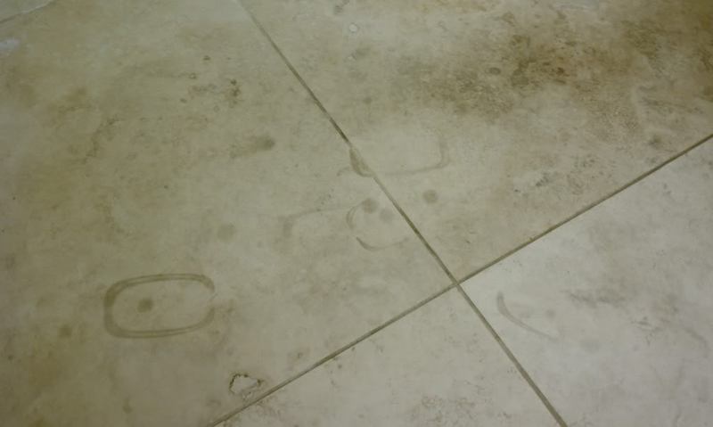

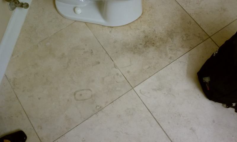

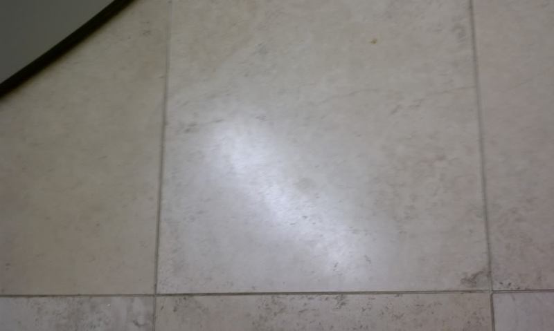

Speaking of travertine. What would you do with this honed travertine? There are a few spots where a bottle of cleaner etched the stone and left a mark by the toilet. Also, a few spots in the LR (not pictured) where stone was etched from consumer using tilex to clean. Would a 400 or 800 grit monkey pad take some of that out w/o adding any shine?

It depends on how deep the etching goes, and how far you want to go with your honing. Alot of the factory honed travertines are honed with lower diamond grits like 200's but at pressures excceeding thousands of pounds. They are usually filled, ground, honed, filled again and a final honing to try to eliminate as many of of the subteranian pores that are characteristic of travertine. Though often when trying to hone, more of these pores are exposed which necessitates needing to fill after honing and touch up honing. Not to mention that honing on site usually can NOT reproduced a factory hone and often will increase the shine so attempting to concentrate on one area results in an uneven appearance.

Thanks David. I was thinking of scrubbing it all with a 400 grit pad and then steam. Don't want to "shine" it. Clean it, remove some minor etching.
I was planning on using some poultice on the marks in the bathroom.

Even the 400 can put a higher shine on it than factory hone. If they have a spare tile, test on it with some etching and your pad.
