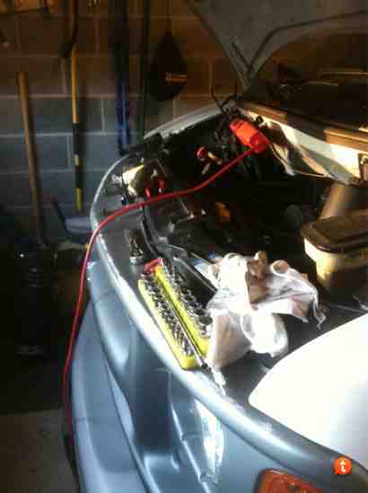

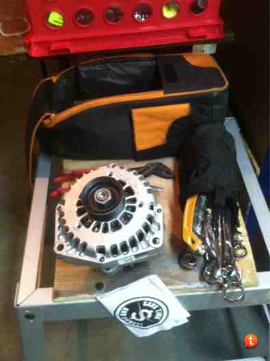

Squeaky Alternator Bearings and a pain in the azz grease gun got fixered today.
Birds chirpin under the hood kill my nerves : )
The Victim!
My lil go bag that has everything to fix anything truck or mount related!

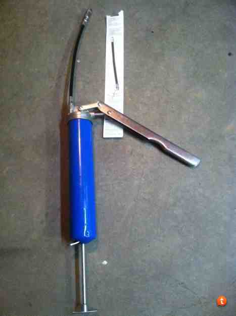

A flexible grease gun hose is a must for any serious blower owner!
Don't be that Guy!
