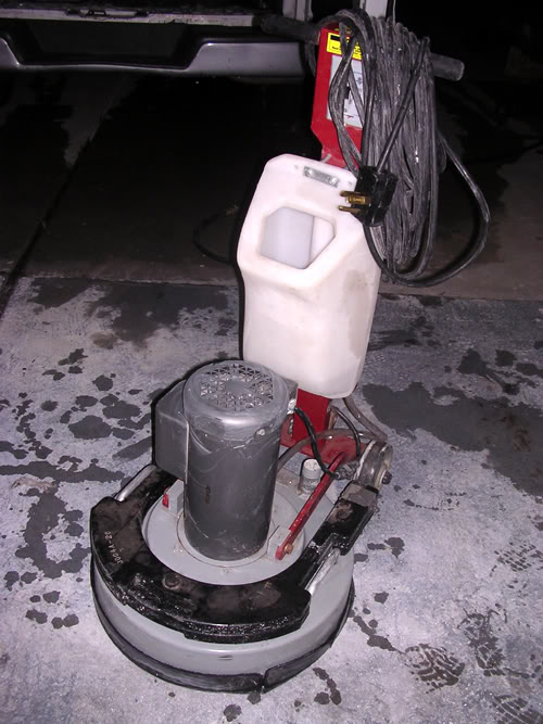

Here I thought I was going to get answers like "Go to another board, I don't know about this". Here's the machine I have that I think would do well in refinishing without having to buy one of those belt sanders.

is that an op machine? you could modify it by putting a vac port on it and make a shroud 2 catch and suck up the dust.

Scott, the machine is like a cimex on steroids. It's triple planetary 3hp 220 volts. With the 2 weights it comes in at 220 lbs. I believe you could put in a few more horseshoe weights. You can see the vac port on the back.

my bad didnt see it until you said somthing. cool. what do you usually use it for?

I bought it for stone restoration. I've done a few jobs with it. Still trying to figure out how to incorporate it into the existing business.
