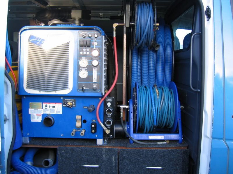

Look, this is not a lawnmower type truckmount and it is built on a steel frame that is covered with wood and carpet.
This Sprinter has been driven HARD because it gets a lot of dirt/gravel/uneven road twice a day.

Zee it looks good. Yours was the one that gave me the idea. My cost to build it would be almost nothing. More time than anything. I have some crazy resources. one of my best friends owns a huge company that builds industrial machines. Almost everything out of stainless. Thermal oxidizers, wet scrubbers ect. I could build something that small out of his scrap. Among other things he is oem for Dwyer and swagelok.
