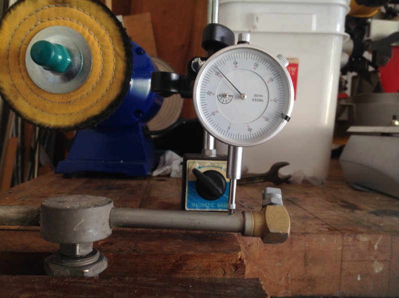

My six-12 has given up the ghost with a little help from my tech and a 13,000 truck. It still works but vibrates so bad it destroys the stainless quick and spinner bearing pretty fast. I just spend an hour and straightened the arms and installed a new bearing but it still vibrates some. I can't stand the vibration so time to buy a new one. It's crazy how strong that plastic is, not one crack. Someone told me the turbo hybrid leaves the tile much drier so I was going to get it. Any thoughts❓

You need to dial in the output shaft where you replaced the bearings id imagine. I dont suppose you have a dial indicator?

I do, but I don't see how that would help. Explain please. It's vibrating because it was run over. I bent back the arms but not perfect. I'll probably never get them in the exact same plane. You can't work on them while the are attached to the bearing. To much force is required. It vibrates enough to damage the male end of the 1/8" quick disconnect and they are both stainless.

You mentioned replacing the bearing. If the shaft is off just a bit you will get vibration. It may not solve the bigger problem but it should help.

13,372
Check it at the shaft attached to the bearing. Maybe on the outer edge of where those shafts are attached. I see there isnt much room there for an indicator.
13,372
Sorry Gene im having trouble explaing it. I dont know part names but where that nut is near the housing and where I imagine the bearing is theres a large cylinder that those shafts attach to. Thats where I would put the indicator. You will have to turn the indicator 90 degrees.

Got it. That makes sense. The bearing is new and it still shakes so I'm sure it's the arms. You can see they are bent. I got them within a few thousands. I'll get a new turbo next week. The sx-12 can be used if we need to run 2.

The wobble destroyed the swivel in about 30 hrs of cleaning. It also completely destroyed the male quick disconnect. High speed vibration is good for nothing, maybe a massage.

Turns out the plastic housing did crack. Right at the top. When your 54 always wear glasses when checking. The wobble was from the top not being secure. I bought the turbo hybrid today and I'll make a large plate for the top of the other one to secure it. It can be a back up it the plate works. Don't see why it wouldn't.
