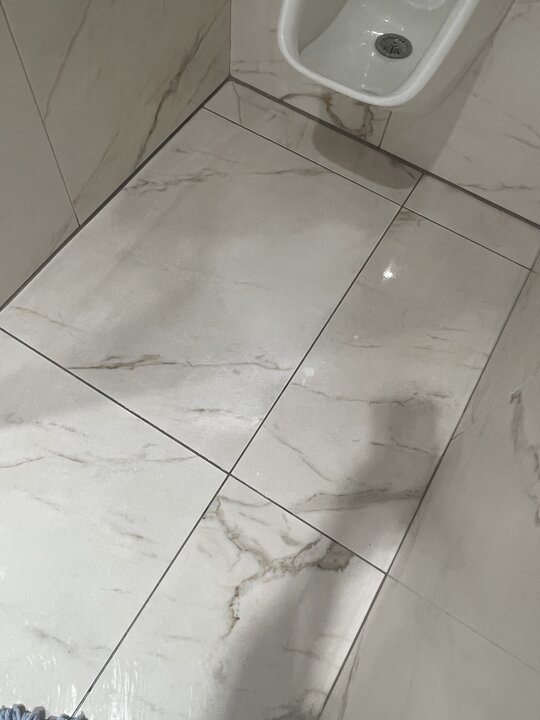

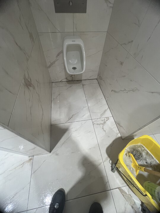

Hey guys, I think I posted about this in here before, but I’ve got this unglazed porcelain that a customer mines used in several of their locations. No pics on this one but I run in the situations where the epoxy grout job was not done well and has absorbed into several areas of the tile and leave some areas kind of splotchy and shiny I usually clean the heck out of it, scrub the shit out of it, and it gets the dirt off the glaze and it kind of looks pretty decent. That’s one location. this other location picture posted here, I can’t use a spinner on it It’s on the fifth floor of a commercial building. I usually end up, scrubbing the hell out of it, scrub The grout put a lot of alkaline on it and pick it all up with a small auto scrubber lotta detailing and I usually looks pretty good but this last time I came in and it looks like somebody either put some acid super pee on it. Couple of drips looks like it cut right through whatever this grime was or maybe they put something else on it. I don’t know what happened to it, but it looks like a cut through this stuff, but I can’t find anything that will do this. Any ideas guys need your help?

Looks like a toilet cleaner to me.
I have unglazed porcelain tile in my home and my wife had dripped something on it that she wasnt sure what it was but we figured it was toilet cleaner. It left a white spot just like in the 2nd picture.
It went away after about a week on its own but we did clean it several times without changing it. One day we noticed it was gone.

Pics attached

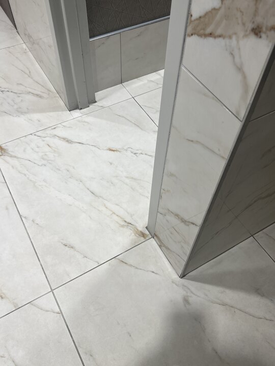

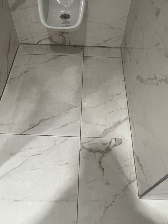

Mike i watched the YouTube video with you and mark on ISSA . I have not run into exactly what your jobs you guys had on there . My stuff actually looks like the dirt or mop water is soaking in the tile . In the dirty areas with the tile cleaner applied the rubber on my shoes will leave impressions in the tile, even the squeegee from our auto scrubber will leave marks like it’s cleaning. I have resorted to sliding and shuffling my shoes across the floor to squeeze the dirt out lol. It does work . I actually put an old shoe on the end of a doodle bug to try it but what works is combination of weight and rubber. The area in urinal is different it’s almost as if the dirt is sealed in . I tried the shoe shuffle, heavy scrubbing course pad and not much improvement. The picture today is after i worked on it a bit more . I also uploaded a few pictures of the cleaning chemicals I found in the janitor closet. I didn’t try any of them . But by the looks of the white splotches on the tile I believe something was spilled on it.

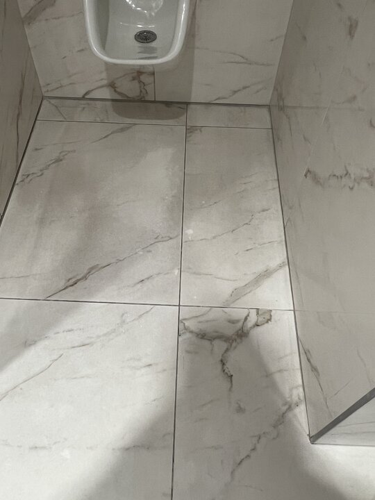

My scrubbing helped a little bit but not much

You could also be dealing with a glaze failure..
Wood and stone-look porcelain tiles and planks made within the last five years can easily be damaged by what we will call "chemical burn" (splotchy, random spots caused by high-pH cleaning agents, heavy foot traffic, office chair wheels and sharp objects, etc.).
In order to make the photograph of whatever the tile is attempting to mimic, the top protective glaze is applied as thin as possible to provide realism. The durability and longevity of this glaze is extremely poor. In some cases, an added protective coating is applied to protect the glaze in the shipping process. This layer is easily damaged and can often be removed with just isopropyl alcohol.
Chemical burn typically happens in traffic lanes and pivot areas where the glaze is already worn, so be sure to inspect for pre-existing damage caused by the homeowner or other professional cleaners prior to estimating/cleaning. Common features of traditional porcelain such as scratch and chip resistance and stain and 1 wear resistance have been lost on these new faux porcelain products. Explaining this to your customers is crucial.
When cleaning, stick with liquid cleaning agents in the 4-8 range on the pH scale. Remember, the tile itself cleans up with just a neutral cleaner, a light scrubbing or dwell time, and a 300-400 PSI rinse. Your goal is to get the grout as clean as possible WITHOUT harming the glaze. Many modern installs will have been installed with polymer-fortified grout which cleans up very easily without extreme chemistry or high PSI.
View attachment 134138 View attachment 134139 View attachment 134140 View attachment 134141 View attachment 134142
