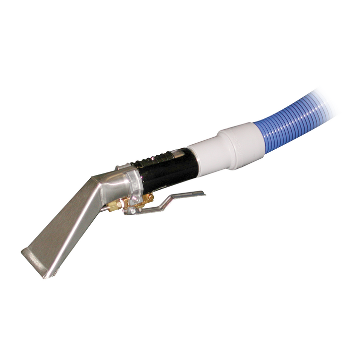

This is a fairly generic tool, which can be produced in large quantities, and versions of which may be made overseas.
This tool sells for between 125.00-150.00:

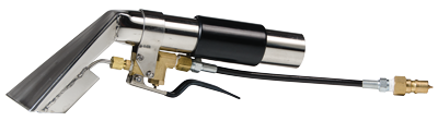

This next tool looks similar, but has several modifications: The jet is internal, with special machining to allow for that type of jet to be used, a vacuum release built in, a solution and vacuum hose that runs internally, and is only sold in limited quanties, so there isn't any economy of scale involved.
This tool sells for 500.00-525.00
Having used and tested Mike's tool myself, it is far ahead of the more expensive tool shown here, both in ease of use and modern design. It should probably sell for 750.00, but my understanding is that it will sell for closer to the second tool listed.

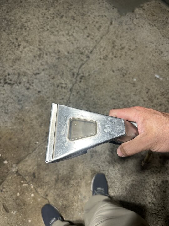

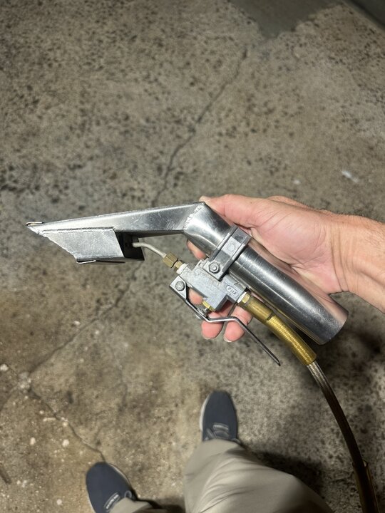

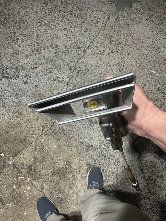

View attachment 132445View attachment 132446View attachment 132447
Lmk how the glide is.. Same same, but different..

Why go to the expense of exotic metals and not stay with a lower cost stainless or aluminum? Is there a specific reason or you just like being able to say Titanium? (I use viton orings in some places where butyl works fine for no other reason than i like saying viton sounds indestructibleWe tested that model extensively, no one liked the head angle and comfort.
Looks like another iteration of a tried and true tool. I can appreciate the ergonomic improvements. Less drag and weight from smaller hose and swivel.
The one most impactful improvement (never addressed by anyone) would be the concept of a partial blocking ability of each side of the vacuum path to accommodate the radius ends of upholstered arms. We all create a block with a finger but it’s not a perfect block. Just a “move” we all use to kinda rinse and vac the “rounds”.
A spring loaded door that could be triggered on the throat body? Door Covering half the vac opening? I’ve never liked the 2 part spray then pull the hose from the tool to rinse. Radius ends get the most touch by human hands than any where else. Especially in commercial settings a piece can come out great but the radius ends look like crap. Just one of those situations I’ve never fully resolved in the past 38 years.
The spray chamber ports keeps it from locking downMike- Is your tool going to have a vac relief?
