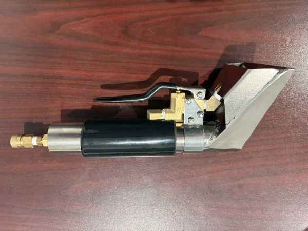

After a lot of testing and dissecting and tweaking we've gotten to the point of me handing the tool back to Westpac and say let's run with it.
The all titanium head will have a very large view window on the front and a inch and a quarter internal hose setup in 10, 15 and 20 ft options
The 01 single jet sits in its own spray chamber that offers amazing over spray control allowing you to clean microfibers and other flat weaves in the very tidy way
The Glide is easily removed if you want to detail staircases and not fret about damage that the tactless will do to your soft Teflon accessory.
There will be a optional and removable heat creating circulating system that will fix to the other end of the hideAhose for those that feel they need full truck mount heat when cleaning upholstery.
I call the Glide an "accessory" because the hand tool also works very well without the Glide when needed such as when doing detail work or very rough sturdy fabrics..
It's extremely comfortable to use due to its angle and lightweight and the flexibility of the swivelized hose
Mr Pemberton used it on a few pieces over the past few days and I'll let him comment on his findings
I'll be with the Westpac team next week where we'll go over some of the details and we may see this fun to use, long needed, versatile tool in production within the next 2 months, hopefully.
I'm not interested in any more suggestions. It's been through the gamut with various veteran specialists has passed muster.
Cost is yet to be determined but my goal is to make it a great value just like the rest of my tools.

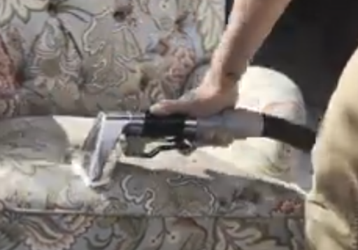

While China prepares to make my first titanium beta head, Ive been cleaning lots of upholstery with the steel mock up
It really is a very nice tool to clean with, in just about every way, especially once you learn it, as all tools need doing
The two items we need to address with the Glide will have to wait until I get the TI version as the end opening will be different and we need to make sure Glide can be taken off and on easily, as this action will happen a lot due to how well it works with out the glide on certain tasks

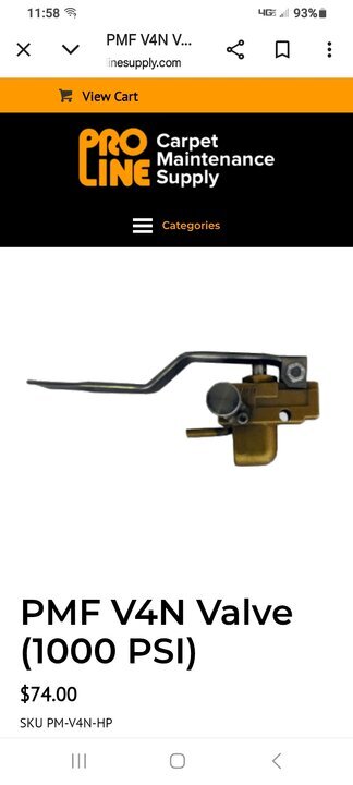

Don’t let pmf do the internal routing. The latest uph tool I bought from them had too much air leakage around the internal components, causing it to overwet it. I had to do some backwoods engineering to fix that crap they refused to take responsibility for
117,178
Pmf has nothing to do with this

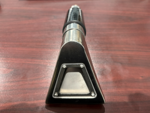

A while back I felt the need to call this tool the "GreenGlide's Jubilee" upholstery tool.
When Jim sent me this photo yesterday I realized I misspelled it
JubiLee is now official.
I have that exact tool I went home with after one of Jim's classes.
After I retired and sold off all my kleenrite, prochem, sapphire and various other tools I kept that one for my personal use.
It's not "exact"
Yours does not have evacuation ports between the two chambers or internal plumbing, or a window or the lightweight of titanium, or my Glide..
But even without all that it's still a good tool

It's not "exact"
Not yours. The one in Lee's photo.

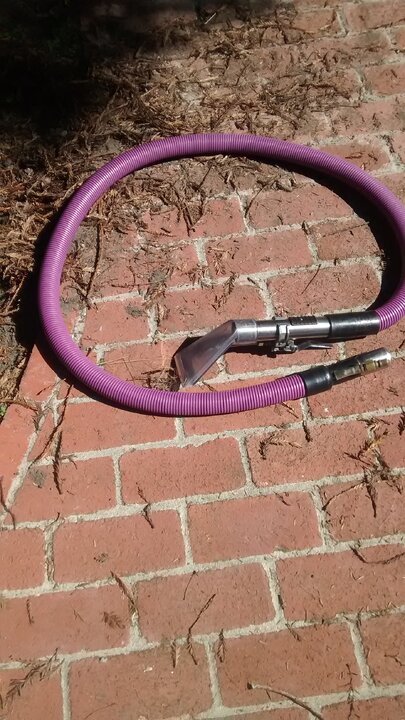

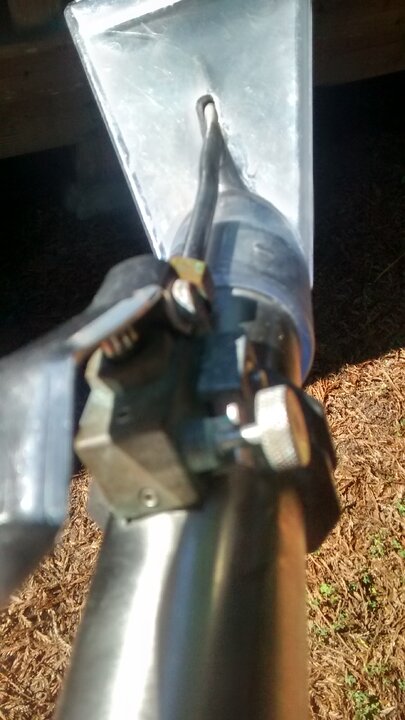

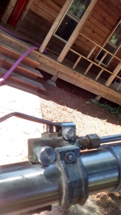

Too bad it doesn't have this valve, i really don't care for this tool. And only use it on the rare occasions that i have to do an auto or rv interior. What i really really really love about it is that it has an continuous adjustable bypass. It keep the solution super hot all the way up to the valve itself .
The stainless needle valve on the side manually controls how much solution if any is bypassed
