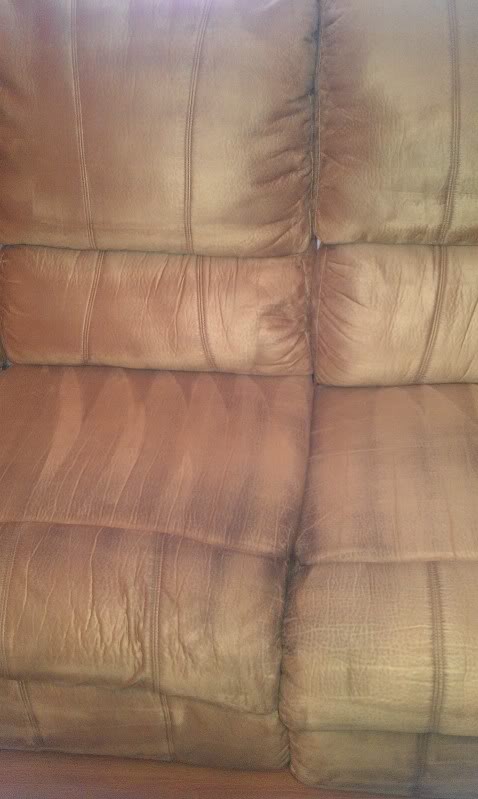

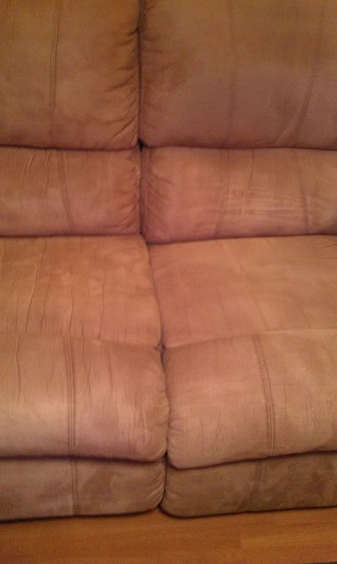

Went back today, tried 3 things:
1-Slop & Gobble, mixed 3 ozs to 20 ozs of water.
2-Had some ultracrap leftover(didn't know I had it), mixed 3 ozs to 20 ozs of water.
3- Poured ammonia on towel.
Did #2 first, applied with white towel, let dwell and extracted at full heat, nothing
Next #1, applied with white towel, let dwell, extracted, cut it fairly well, but still could see the black.
Last, did the ammonia, this was the winner.
Before
After

Nice job Vince. I will put that in your file. Remember just cuz you get a lot of call backs does not mean you are a Hack.

Nice. Here is my dumb question: what kind of ammonia did you use? Just plain non sudsing ammonia that you get at Wally world? Or is there a product that is sold at a carpet supply house? How did you mix it?
vincent
1,899
O'Fallon, MO
Vincent Sapp
just plain ammonia, didn't mix, poured directly onto towel and the worked in.
