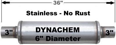

using high flo 4 I.D muffler for #5 blower

Would a straight through 4 I.D high flo muffler be TOO LOUD?
Depends on what "too loud" means to you. I like the looks of it though. I have often thought a longer muffler with an adequate i.d. would do as well or better than a short choked down silencer. Only speculation though. It is another thing I have thought but not tried.

You don't need a muffler for the blower. Call Les Jones and talk to him about the resonator he uses for their blowers. There was one at M fest and there was no noise coming from the blower exhaust.
Once you muffle the engine exhaust and then the blower exhaust, all you have left is blower noise and vibration noise. Look at the new Vortex....it was loud until they enclosed the blower.

Ashley;
The muffler in your picture is too short for effective silencing.
This is the minimum length that we have found to be effective on a #5:
Larry

Larry, what is the actual measurement of the shell of that silencer without the inlet and outlet. I was going to order one but want to make sure it will fit.

On the Dyno cones:
Typically good for a 1-3 reduction in dB.
That is not very much.
Lance is correct, Les's new silencer is pretty impressive for a short fat package.
