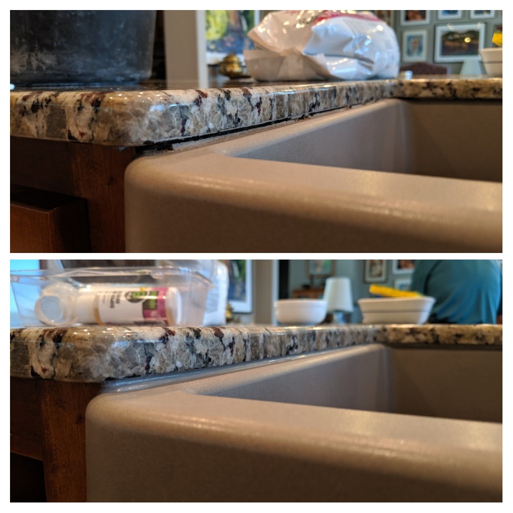

That looks like it's going to continue downward. Have they been sitting on the sink? Is the sink sitting on the cabinet frame?

I was going to regrout a cast iron kitchen sink to granite counter top with SGA today, but got hung up trying to skim-coat a shower floor. Couldn't get SGA grout to bond well to this non-sanded grout. Would suspect soap scum is preventing the bond, but used Soap Scum Magic and Acid Restorer on different areas, then ground grout down with oscillating tool with diamond blade. Used SGA successfully on a tub enclosure with presumably the same grout at the same location.
