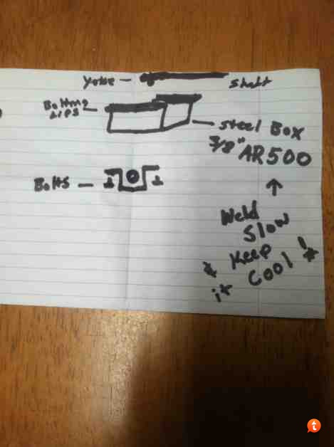

back in October I had the pillow blacks and U joints replaced, three years or so the fitst yoke off the pto blew apart (not getting lubed by my chimp) and now the spline shaft is bent so while their at it I'm replacing the all yokes before she blows...
https://www.youtube.com/watch?v=buoGIOTzp5E
Not sure how it got bent, could be one of the transmission goobers dropped it or possibly when the 1st yoke blew apart but I would have though the noise and bouncing that showed up yesterday would have reared it's ugly head a lot sooner.
$250 in parts, 2.5 hours labor.
Found a great pto supply place down in Salinas that had everything (5 pieces) in stock and loads of knowledge and I'm blessed to have a local machine and fabrication shop to fix it all. Farm gear is their specialty so the POS Vortex is nothing special
