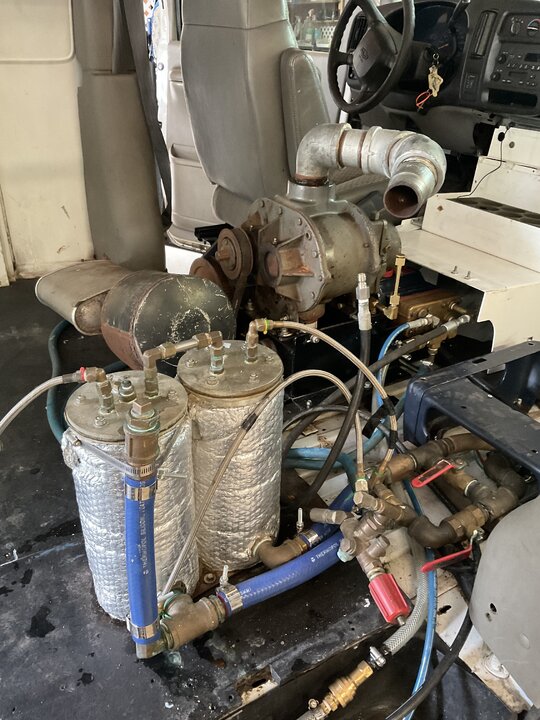

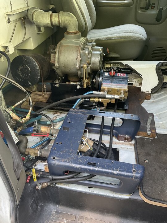

My engine temp in my van has been fluctuating a bit. 80% of the time it is normal, reading 210 on the gauge on my dashboard. However 20% of the time it fluctuates up to 220 to 225 then comes back down to 210. It isn't a matter of whether I am stopped/idling or cruising at highway speed. It does it in both situations seemingly equally.
Then today I just left the ball valve to my tm heat exchanger wide open while driving and the van engine maintained a consistent 210 the whole day without a single fluctuation. I'm often worried about the engine overheating when I run the tm for hours..

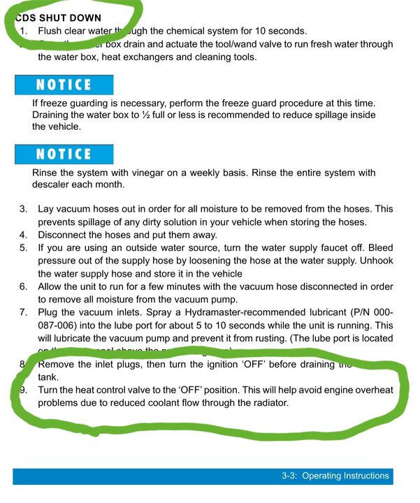

I didn't read it on Google AI originally, I think it was mentioned briefly on one of Hydramasters maintenance videos. But they recommend leaving the coolant valve closed while driving as to not overtax the engine coolant system. I assumed they meant it would overwork the water pump but I never thought about it much and just closed it every time I drive. Anyways this came up on Shmoogle AI for what it's worth:
"Based on information found in HydraMaster manuals and forum discussions, you should never leave the coolant flow open while driving, as
this is a potential cause of overheating. The HydraMaster CDS (Clutch Drive System) is designed to operate only when the vehicle's parking brake is engaged, and the control system should shut off the unit if the van is put into motion.
Here is a breakdown of why this is important and what can cause it to happen.
Risk of overheating
The HydraMaster CDS uses the host vehicle's engine and coolant system to operate.
When the unit is on and running, it places an extra load on the vehicle's engine and cooling system...."

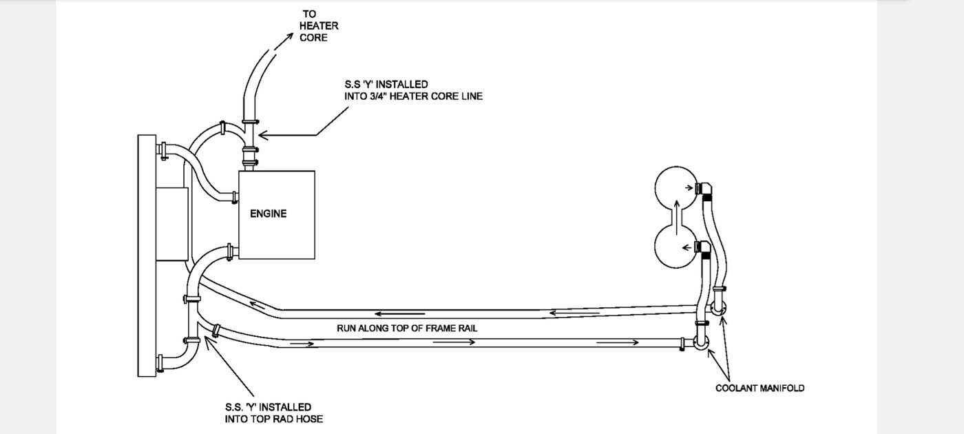

If you look closely at the diagram and can read / picture the flow youll see that my system is paralleled. A paralleled system can be closed off whereas if it were in series it couldn't be shut off without effecting what ever else is up or downstream

That's a good call, if it works fine open then leave it open!
Risk of overheating
If the valve is open more coolant is flowing thru the system to absorb and distribute the heat. In the old days before fan clutches and shrouds if you drove thru the desert you turned on the heater to have a little extra cooling for your engine. So if you have 2 extra gallons of coolant in the system you now have that much more cooling capacity
From the diagram it looks like one HX in your setup receives coolant from the inlet side of your engine, and the other HX receives coolant from the outlet side of your engine. And yet each HX flows into the other HX directly. Its like a big engine coolant party you have going on there Dwain-o. Forgive me I don't understand the difference between parallel and series setups. I should because I learned about that in DC electrical when I was setting up solar panels on few RVs and a cabin. Maybe that was completely different though...

No it recives heat from the upper radiator hose going from the engine to the radiator and it returns spent coolant back into the engine thru the heater hose in

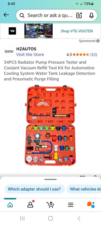

I used a vacuum system to fill my coolant system

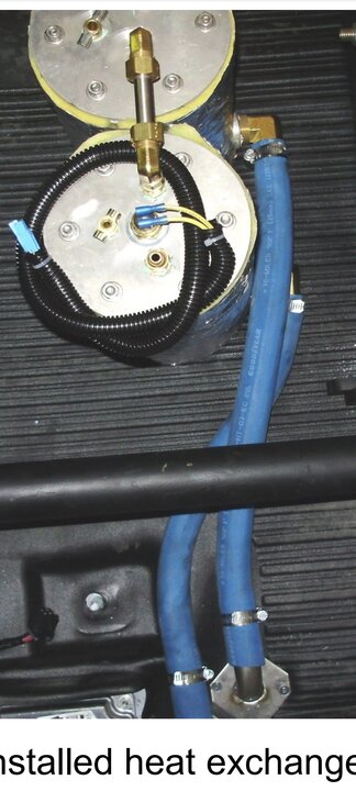

Maybe when I attached the new HX I reversed the 2 lines coming from the engine and it screwed the flow up. The 2 lines were connected to one another and the old busted HX was bypassed for a while, the incoming and outgoing coolant hoses from the engine weren't labeled. I'll look at a diagram in the manual and see which way it should be routed before I drain the coolant to address the thermostat housing. 😏
Shouldn't matter as far as flow of coolant thru the heat exchanger is concerned. However it could affect the amount of heat you get outa your soulition. The hottest coolant should go into the the side where the hottestt soulition comes out. If reversed the cooler coolant would take heat from the soulition cooler(spent) coolant leaving the heat exchanger should be heating the colder soulition coming in
Easiest redneck way to find out which side is supply and which is return ( if you can't trace the hoses) is while van engine is cold, start engine and hold each coolant hoses in your hands , the one that heats up first is supply ( hot in) the cooler one is return
