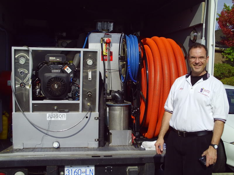

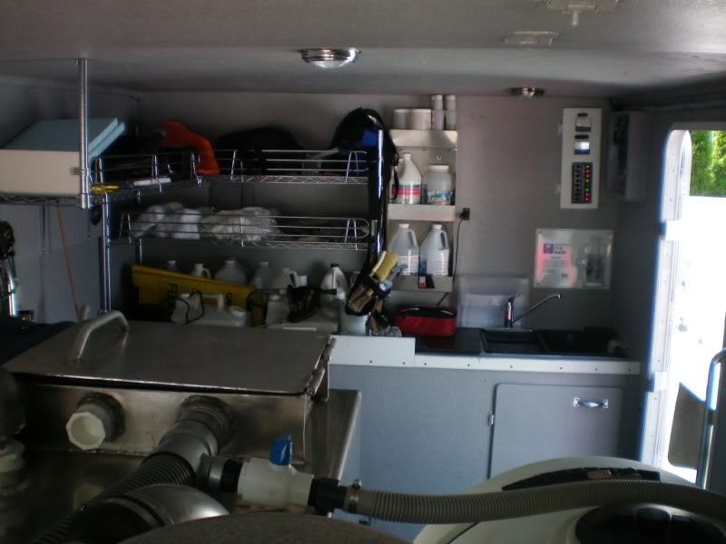

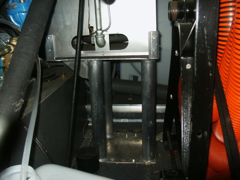

Nice set up Bob! I don’t know if I have ever seen a slide-in that sets on top of the recovery tank like that. I am defiantly going for a box truck next time. Another advantage to box vans is that rust is less of an issue. I bet I spend 2-3 hours per week just loading and unloading equipment from my van to my garage.
Bob Foster
8,870
Thanks. I did a little more fiddling around and found homes for some of the other tools. The Little Giant is being vented outside the truck next week.
The truck has power ventilation and is designed to run doors shut for security and noise considerations.
