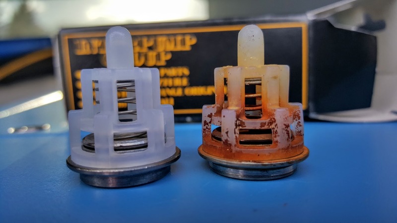

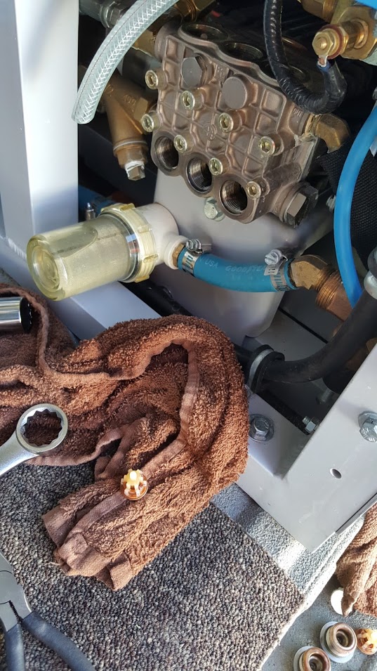

Vegas was rough on my 370.
116,206
Cooked my check valves when the pressure thermostat/ pressure relief failed..
sitting at 280 for an hour or more will do that to an air cooled unit

easy access on the 370 though..
I was getting 300 psi drop.
which goes unnoticed under the RV due to that it cleans fine at 100psi...lol

I can't answer that..wasn't paying attention. But without water flowing even the 370 gets to 280°, and stays there.
Getting to 280 on a little truck mount doesn't seem very good. Either it's working too hard, or it's not maintaining the heat it should be providing.

Get a spare set of seals for your parts box as they are super easy to change out on a job.
If the checks were fried the seals needed to be changed at the same time.
