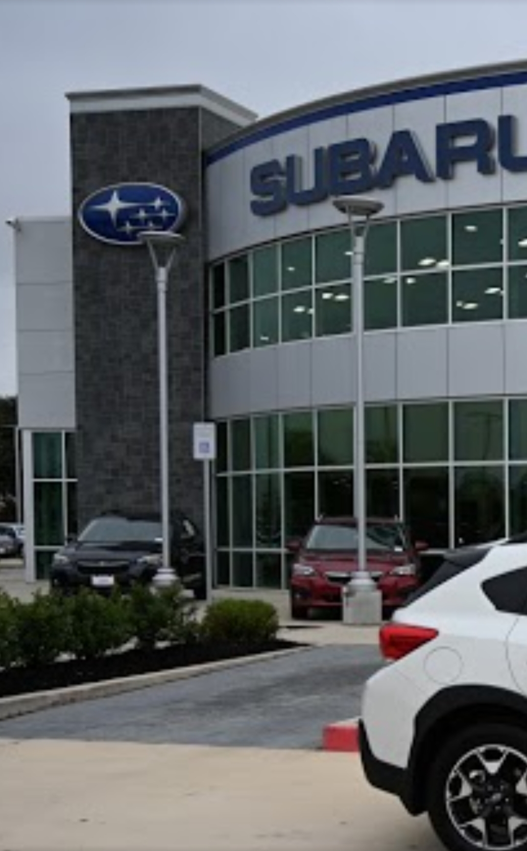

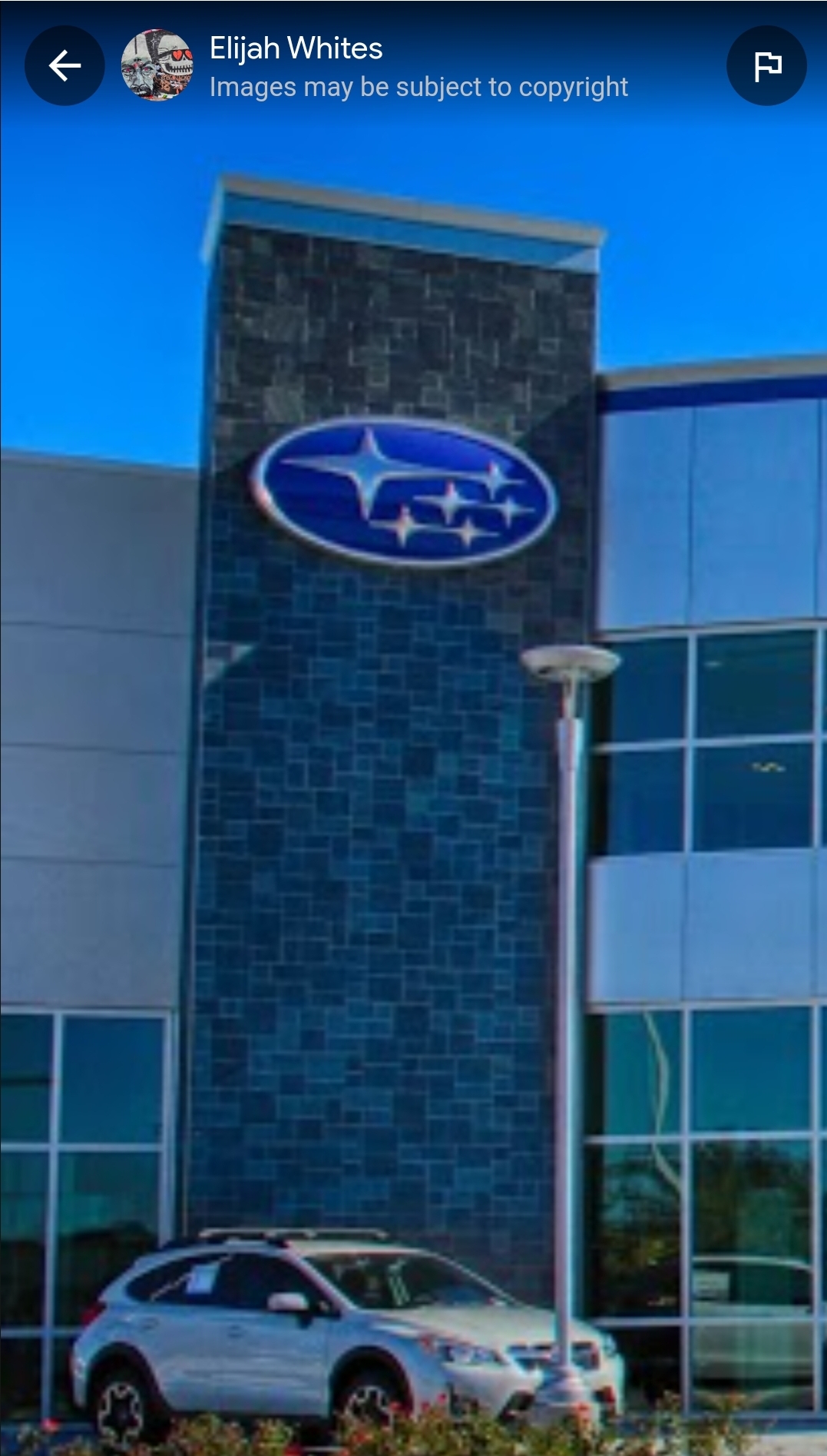

I have a guy that is wanting efflorescence removal on his slate wall at his dealership. I'm familiar with efflorescence removal, and sealing. What I'm not familiar with is quoting vertical surfaces/time required to clean and seal. Anybody want to butt in on what they might charge for this? Would it be better to do a sq/ft or hourly price? I will be masking off all surrounding areas as to the nature of efflorescence removal and wanting to protect their property. Here's the job friends. P.s. they have a sky jack that we will be allowed to use.. it will be essentially 2 sides. The other 2 are small biscuits.
View attachment 108728 View attachment 108729
You don't have to itemize line items. You can do your computations, come up with what you feel the job is worth and just put a total.
You can put verbiage like "the total includes labor & materials necessary to complete the project."
10,221
If you know what you would charge on a floor, I would use the same as a reference point, then start factoring in the Pain in the ass charge cause it’s gonna be that. I would hate to do a floor in a dealership must less that. Plus they are as cheap as doctors! Or more.

Where is this located?
Dfw, Tx. I'm almost certain the water is not coming from behind the tile as there is a cap on the "monolith" as seen in photos, and they would have bigger problems if it is coming from the interior of the building, why I think it must be rain water as well as the way the efflorescence is forming on the tile. I was going to offer 1 year warranty after I sealed it but maybe that's not going to be such a great idea. I might just have a conversation about continued maintenance if he is not ok with a no warranty policy on the sealer.

Pictures are not clear enough to see. 2 options to remove are chemical or mechanical. on vertical gravity work against you, so i would media blast clean if needed
Dry treat is some stinky sealer, expensive also, so you better factor that in if you go that route. we did an entire limestone pool deck with dry treat sk-40 after grinding to repitch standing water to secondary catches
I would also be asking if he wants to keep the natural look or if he wants to enhance.
