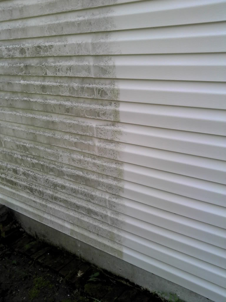

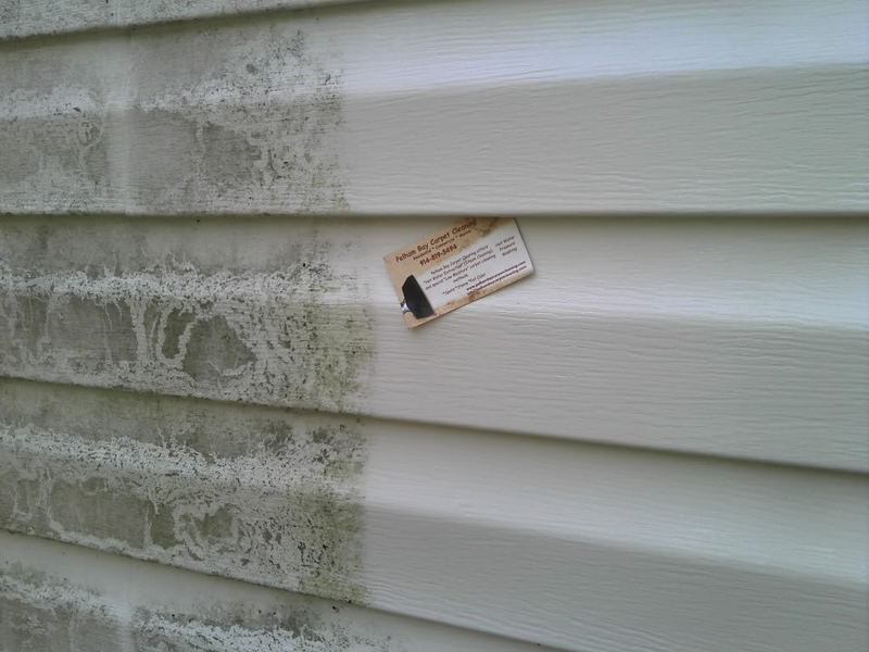

Chems will loosen most of it up with a good scrub brush, but a pressure washer will "Peel" it right off vinyl siding pretty easily..

Alfalfa said:
What size unit did you use on it, how many btu's?
My unit is 4 gallons per minute, up to 4000 psi. It's on the smaller end of commercial units, but gets most of my jobs completed in decent time. It's the GPM volume that makes a big difference over smaller units. I used cold water on this job, and probably around 1500 psi. If the vinyl siding is in nice condition, it really comes off easy. If your cleaning higher than your shoulders, an extension pole with a 90 degree adapter will keep you from forcing the water under the siding, as you can come at it from a downward angle.
Do you have to worry about recovery there or can it just land on the ground?
Cold water did the job on that one! That volume sure makes a difference.
