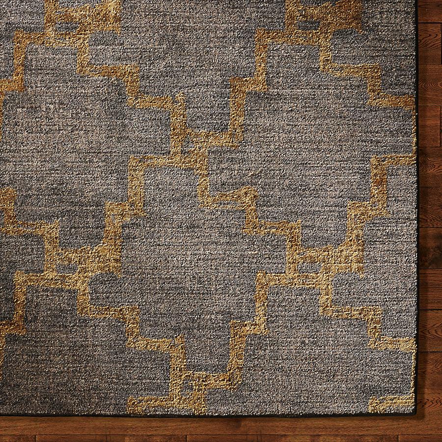

I have washed those Restoration Hardware rugs, like BC Ron cleaned, with no problems so far

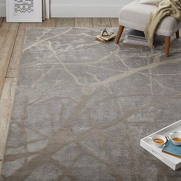

Customer called with this "Cactus Thistle" rug with a pee spot.
How many names are there for this stuff?
