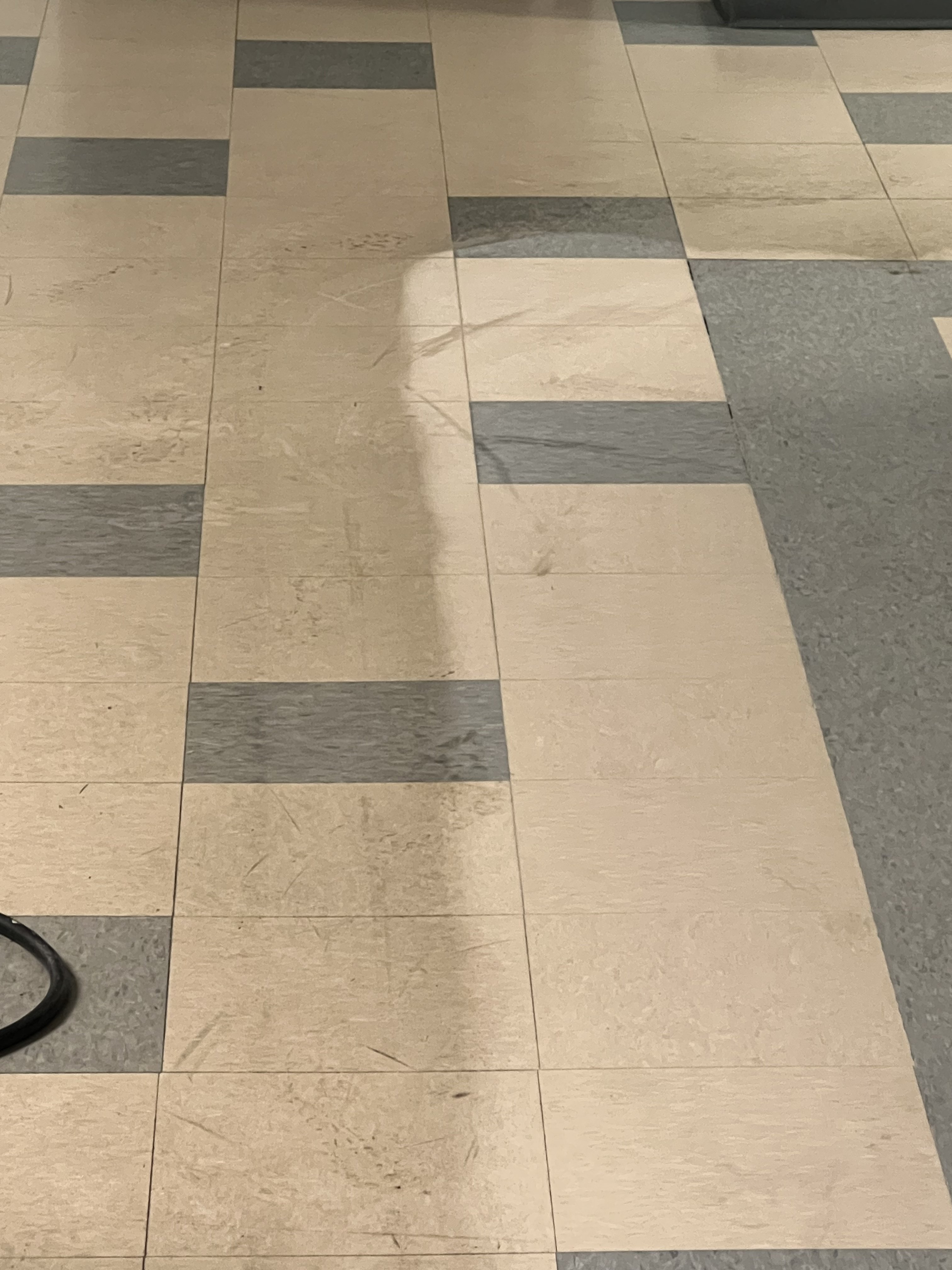

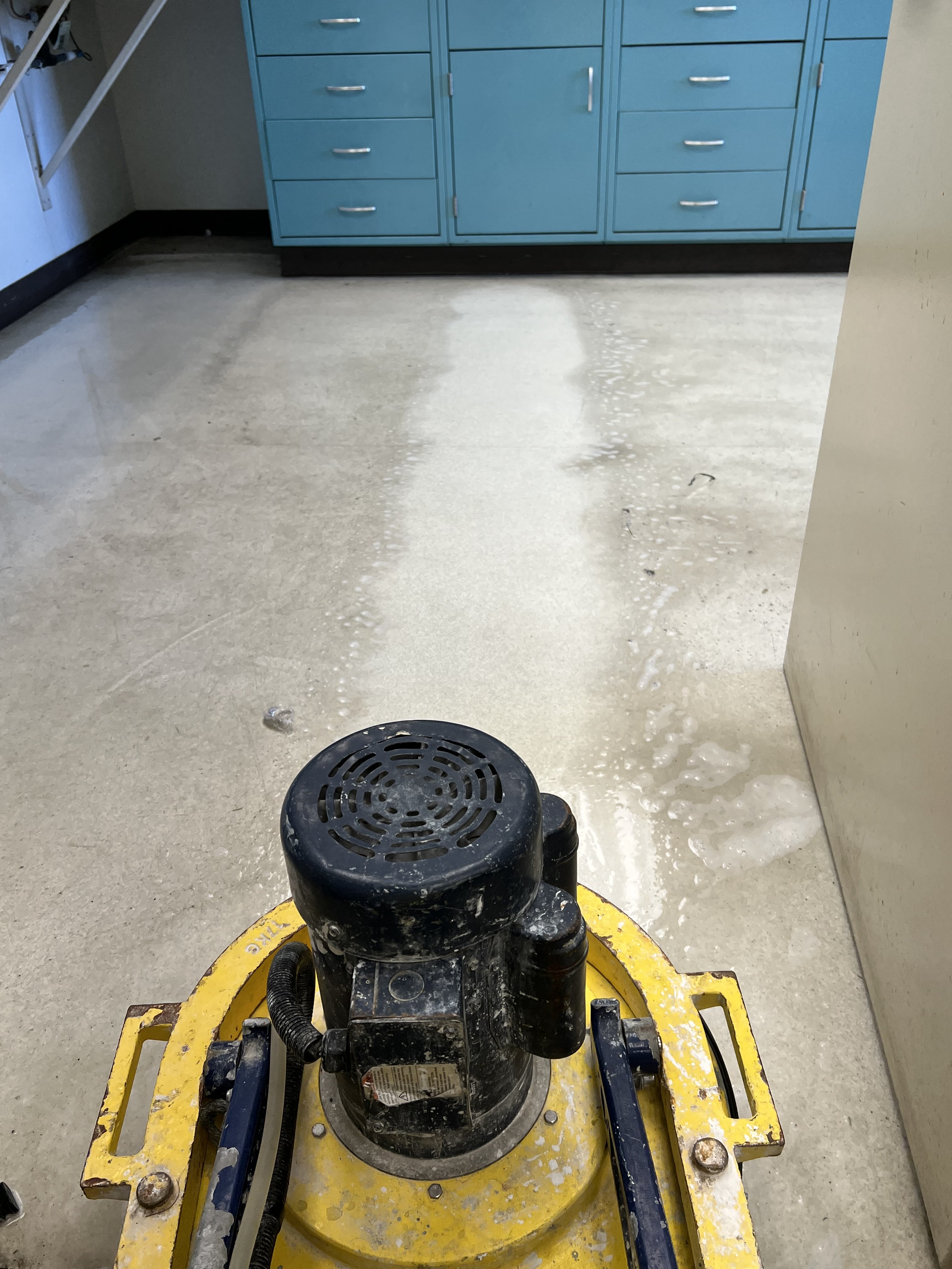

I called a company that sells that Cimex and he said he had never heard of someone using it for VCT, and wouldn't recommend it.
Good enough for me.
Top pic was using neutral cleaner and SPP pads, the second and the video are of a strip out at a water treatment plant using Betco Extreme stripper and Alligator pads from Excellentsupply. Both jobs used the Cimex Diamond Finisher shown in the video. It’s heavier and spins faster than a CR48 Cimex for carpet.
