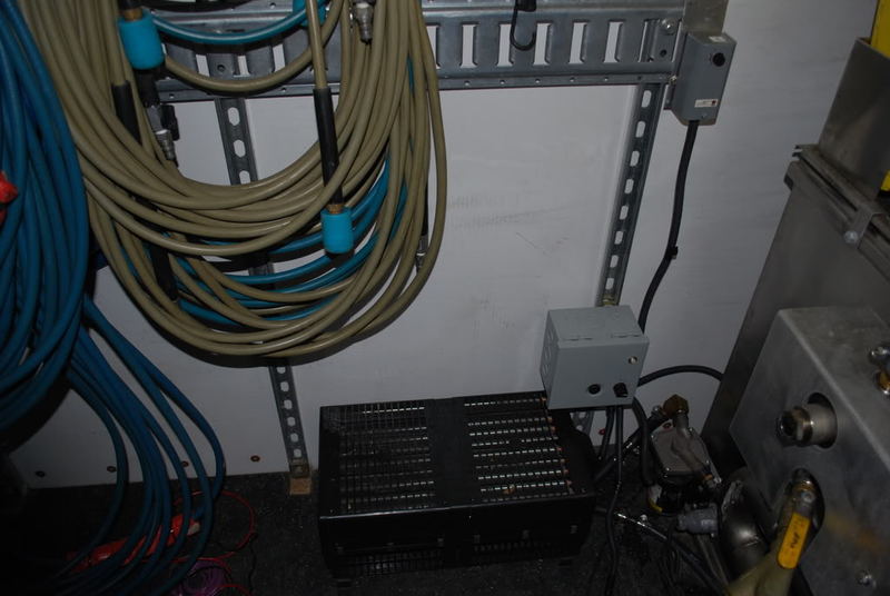

I finished installing the coolant heater in the Vortex yesterday. I installed it with a thermostat and remote temp probe to get the heat where I needed it.

Is that the heater from FMI? Does it have a fan?
please let me know how well it works, I am considering purchase one

I bought the heater kit from Blueline. The heater has 2 fans, keeps the box nice and warm. Call Chuck Cushman he can send you everything you need to install it. :wink:

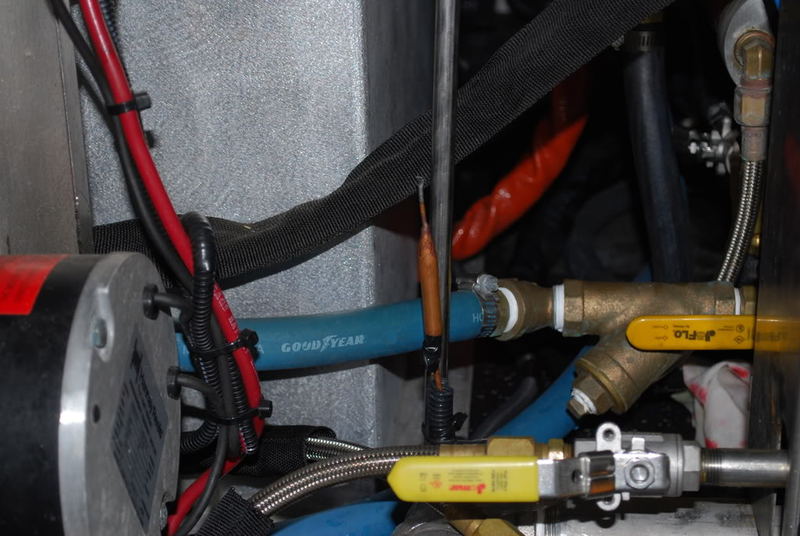

Anthony, I don't notice any drop in water temp. Any heat I would loss with the coolant would be made up by the exhaust heat exchange.

Ron,
At what point in the coolant system does the heater come into play, before liquid HX or after?

Jeff, The heater is plumbed in right after the coolant exits the s/s coil in the bottom of the fresh water tank. It pulls the water through the heater then returns it to the loop, to the liquid heat exchange. I will probably have both the Vortex's at Winterfest, you can get a better look at the heaters then.

Bah.....these things hook up just like the one in my 86 chev suburban....an IN and an OUT with a red wire for power and a black wire for ground....
yea but i want it easier....
that picture looked like a cluster to me..
now i need to get off my arse and put one in my self.. :shock:
