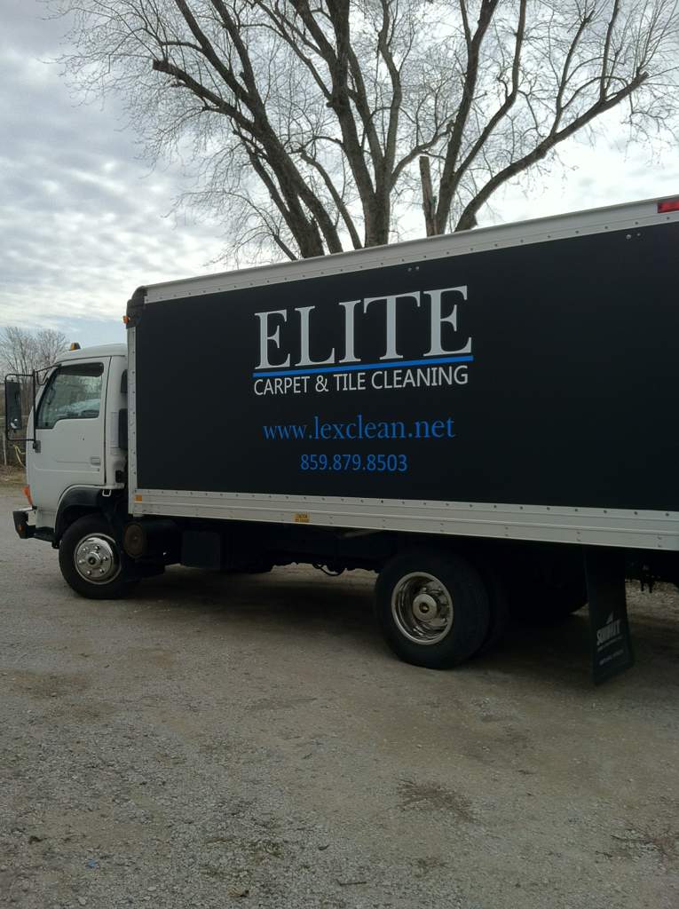

Did everything with a $300 eBay plotter. My wife and I did all the work, had allot of fun doing it
Did a complete 180deg on the ideas we originally posted, and stuck with the "Less is more" idea (Thanks to my wife)
YES it will have Wheel Simulators, they should be shipped out by tomorrow morning (Wheelsimulators.com)

Wheel simulators installed, they really set everything off, absolutely in love with this truck.

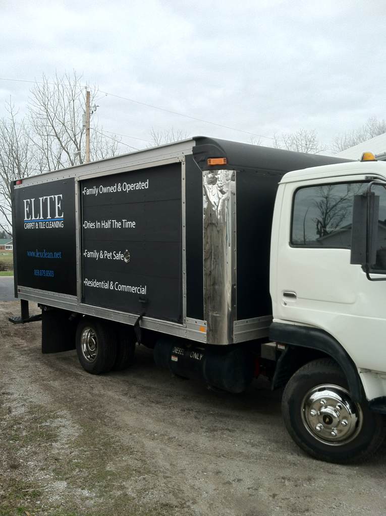

Ashley, can you briefly explain the process of putting the black vynil on ??? it really looks good. I have a small box truck I'd like to do something like that with.
AshleyMckendree
Sep 1, 2007
1,572
Versailles ky
Ashley Mckendree
It's just like laying wallpaper if you have ever done that.
We made a solution of water w/20% alcohol and a few drops of soap in a pump up sprayer, spray the substrate, peel backing off of vinyl, apply vinyl to box and it will "float" around on the box because of the spray, allowing for movement and adjustments, once you have it where you want it , just squeegee out the water with firm movements,( we used a Teflon squeegee just for this application.) this sets the adhesive and it's not going ANYWHERE after the water is pushed out.
There where maybe 4 bubbles I couldn't budge, so an exacto knife came in handy.
This box was very easy due to not having rivets, if it had any it would have taken a heat gun and a "rivet brush" to form them tightly around them.

Look up Wabash Trailer in your area. They may have a cheap alternative to covering the beat up chrome corners. I had planned on using something to just recover them and rebolt in same holes.

What size vinyl (width) did you use? 30"
Hard to see in photos, did you butt the vinyl or overlay? We overlapped about 1/4, you have to look very close to tell.
Is the color matte? Yes, it is Matte Black
My truck has a million rivets! Check out this tool for wrapping over rivets: http://www.rollepro.com/
