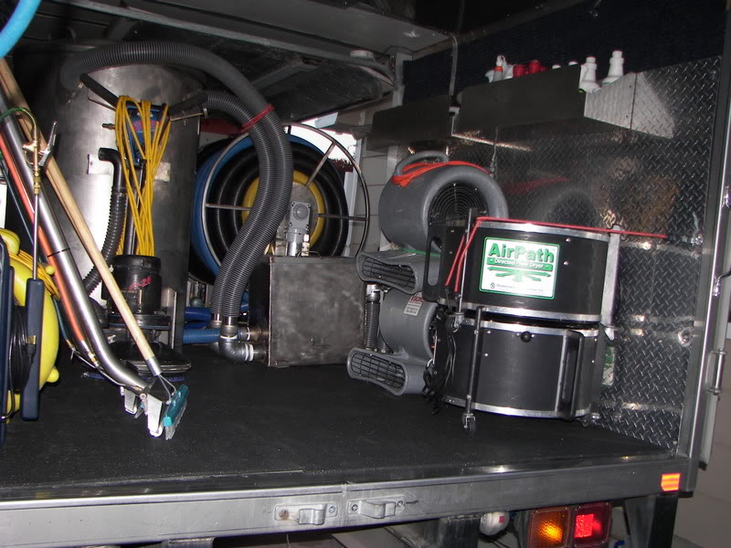

adamh
1,533
Adam Hale
This is what I have done. I have the two 2.5" hoses and the one 2" coming from the tank going into a filter box. Then two 2.5" going out the truck. I have taken the elbows out.
