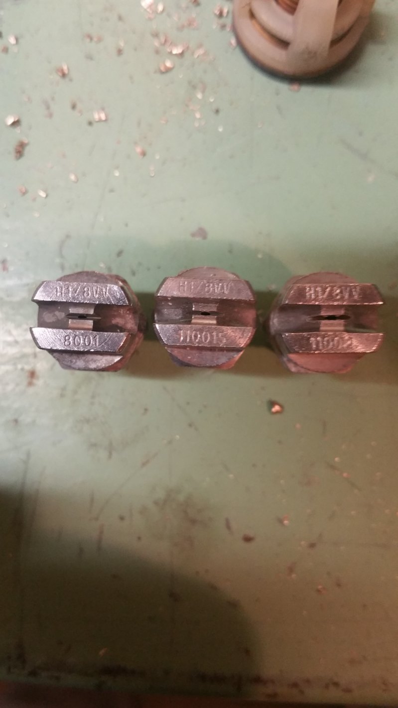

Cody, I run 6 01 jets (6 flow) or 6 1.5 jets (9 flow). Ti 2" wand with glides. 450-500 ish psi, depends on length of hose. I run Airpaths too. It can feel almost dry in places when I leave. BUT I always tell them they can go back to normal living in a couple of hours but I warn them to not move furniture off blocks or put any furniture on to the carpet until the next day. You can never get all the moisture out in the same day if you deep clean, especially RE.

Wait are we doing 12 flow or 6? I sell all my 1.5 inch wands and whip hoses now everyone is back to 6 flow and tiny hoses.
Gotta sell the 870 now. Geez it's hard not to be a hack.
Maybe bane was right all along.
Actually I'm kinda happy. I was about a year away from a 2.5 inch titanium wand with 24 flow and 3 inch main vac lines.
