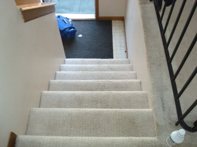

WANDING THE STAIRS (again)
B
breathe72
A rental job.

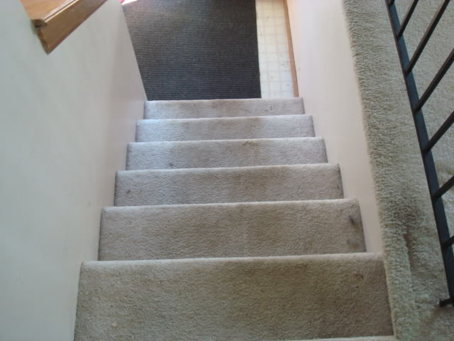

Chris, Stairs look good.
If you take a bottle with 40% (your fav encap) and 60% water a quick spray and brush on the edges will clean those filtration lines right up.
117,324
Did you pre vac those things?
Maybe its the lighting but to my eyes it looks like they'll wick.
S
Scott Rogers
Hey Mikey, there is some pretty substantial fiber damage there. I was thinking it was probably that and lighting giving it that look.
Pictures can be pretty deceiving compared to the actual finished job.

I thought it was just the camera making them look dirty still, that flight of stairs is asking for a pre-vac and a quick pre-scrub.
Art Kelley
May 19, 2007
4,200
Either that, or a post-scrub with the 175 and one more rinsing with the floor wand. And a toweling off to expedite drying and remove those scratch marks That's what I would do. It looks hackish and awkward but a floor wand (and a floor machine) cleans much more efficiently than a stair tool and a hand brush. Think of the worst traffic lane in a house (which stairs usually are). Would you rather use a 5 inch wide .02 flow hand tool, or a 14 inch wide .12 flow glided Ti wand?

Greenie said:
Is that vinyl on top of that carpet at the bottom of the stairs?
Its one of those cheap runners Greenie.
I pre-vacced AND pre-scrubbed these, lol.
This place was so disgusting, I had to.
If you think the stairs cleaned up like shit, then you would have really groaned when you saw the rest of the house.
Its a rental that belongs to a lady who teaches with my wife.
