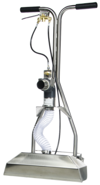

Call Rotovac for a 2 week trial of the new 360i. It now comes with either a 12" standard head or a special new 15" head with Teflon vac ports that produce amazing dry times. Ask for Mike Linderman and I will include the freight if you decide to buy it after trying.
