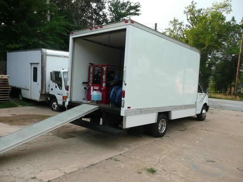

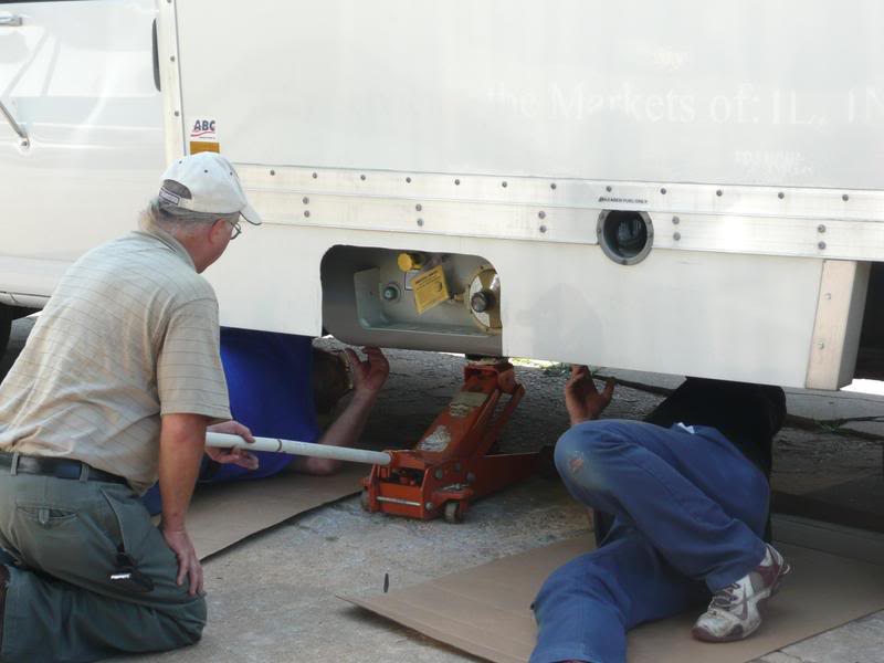

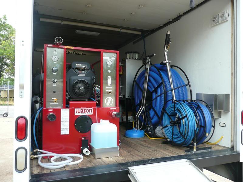

We first started the installation with a extra large propane tank, due to all the room under the boxtruck. This large tank will give Warren over 60 hours trigger time before refilling. The cost to fill this bottle was under $90.00. That's $1.50 an hour to have continuous trouble free, low maintenance 240 Degrees on a Greenie highflow wand.

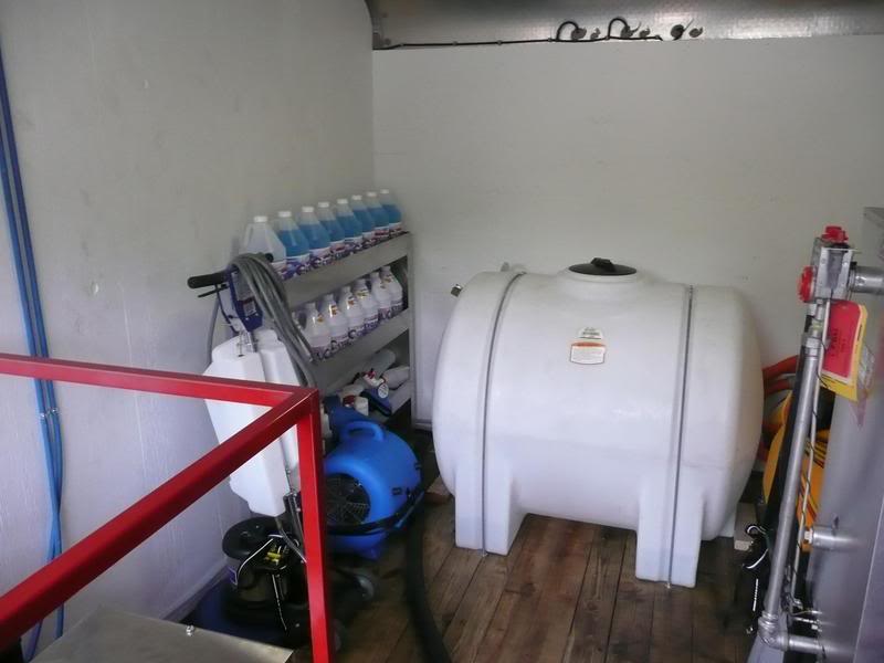

The box truck was a 14'. We installed a 225 gallon fresh water tank. We also organized and strapped down all the other equipment that he wanted to carry with him on the truck.

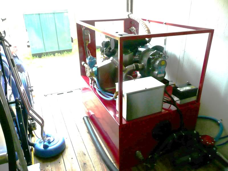

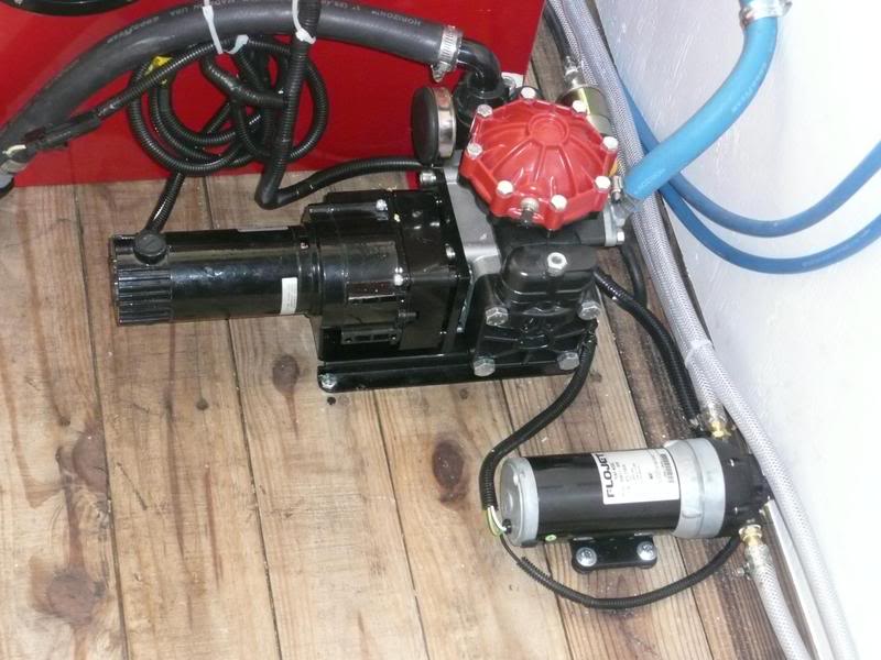

Photo of pump-out system and fresh water transfer pump.

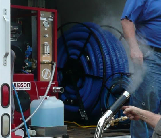

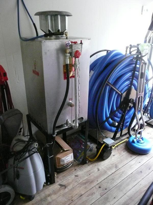

Photo of #4HT High Pressure Heater and Electric Vacuum Hose Reel.

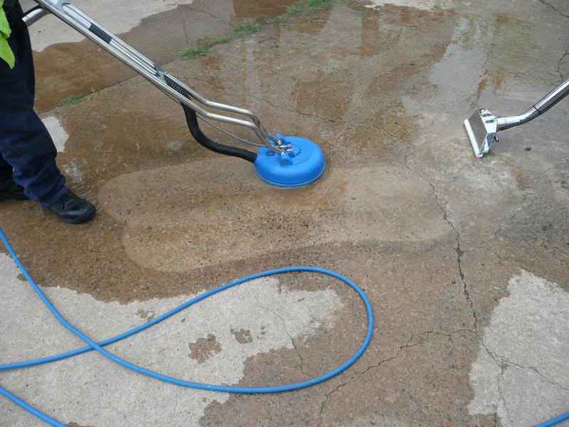

Running a spinner tool on concrete at 1200 Psi. 220 Degrees sustained.
The truck had a nice ramp, no more lifting heavy equipment in and out.

Nice set up...What is the small pump that is sitting beside the PTO
That is the same PTO that they put in the AT and the Vortex..............

Jim,
That is a Blue Line APO..
The flojet ...pump is an assist pump for the Fresh Water pump...Probably 45psi...

HARPER said:
Jim,
Blueline ....Vortex.... AT... all the same animal.... same APO....
the flojet assist the pump...?? what type of water pump is it sporting.....

Jim Martin said:
HARPER said:
Jim,
Sure-flo Make a 12 volt pump like that. I have one at my shop. If I can I'll post a picture. Nice set-up Les. You and your family does great quality work.

Thanks, Shane...
Transfer is the correct term... :oops: "Not enough Caffine in my system yet."

Ed Prevost
Very, very nice, but is it just the way the picture looks or should you have taken the Cimex and autoscrubber out berfore the install. It looks to me like they are trapped!
