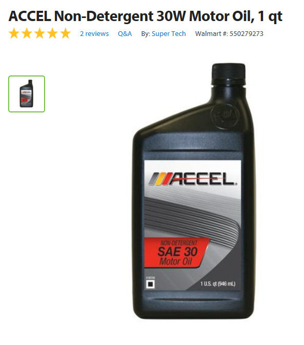

Cat pump oil is an ISO 68 (which is 30 weight) non-detergent hydraulic oil. If you are just going to run the oil a short time to flush out the water then any inexpensive 30W non-detergent oil would be fine.
Buy the right stuff once the water is flushed out and the seals are replaced.
Dan that's why I like th Lucas hydraulic fluid, ISO 68 and cheap like 16 dollars for the gallon and has lubricity additives for better protection.
Reactions: dgardner
Most quarts of oil now days are on the higher side of 3 dollar to 4 dollar a quart.
So I just get the gallon of the good stuff.

Ah - very good. The stuff I posted is like $2.75 a quart - good for a cheap flush or to run for a few hours if the seals are still leaking, I wouldn't run it for hundreds of hours though.

I have. No noticeable difference, other than the horrified reaction some have.
Clean oil, and enough oil is much better than the alternative.
Agreed. If the oil is changed often enough and kept at the right level, then fancy additives are moot. I'm just reluctant to tell someone to run that oil regularly, though truth be told I personally would....
