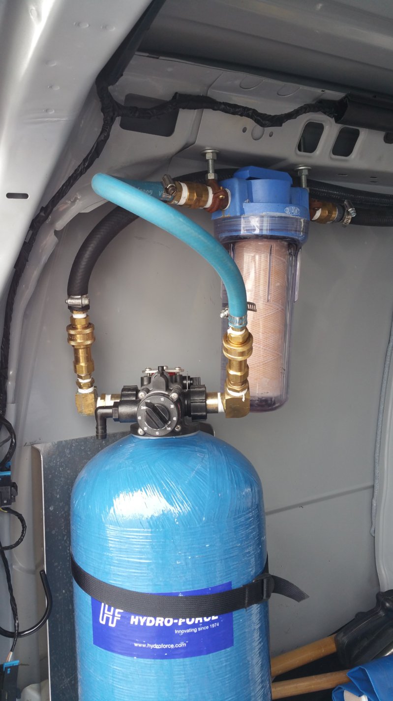

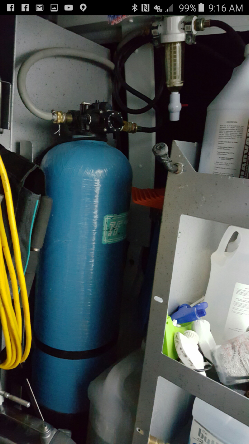

I have a water softener in both vans that we use. I filter the incoming water first, then into the softener, and then into the fresh water tank. I use test strips to determine when it is time to regenerate. I regen at the shop by adding bulk table salt into the top of the unit, switching a valve to regen, and place that hose into the sewer drain. It takes 20 minutes.
Soft water makes such a difference in your cleaning results, and maintaining your equipment internally. I highly recommend you get one if you don't already have one.
