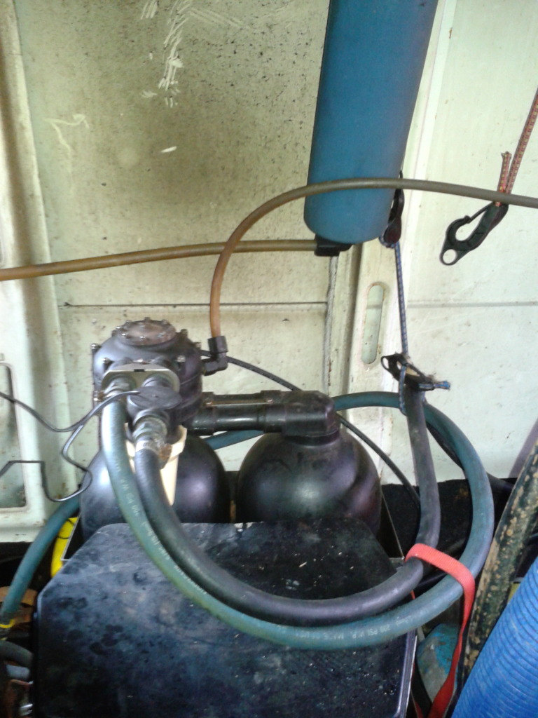

I've been running this Kinetico since 1992. Alittle rough looking, but still does the job. The first pic......hose running to the left is brine hose to waste tank.

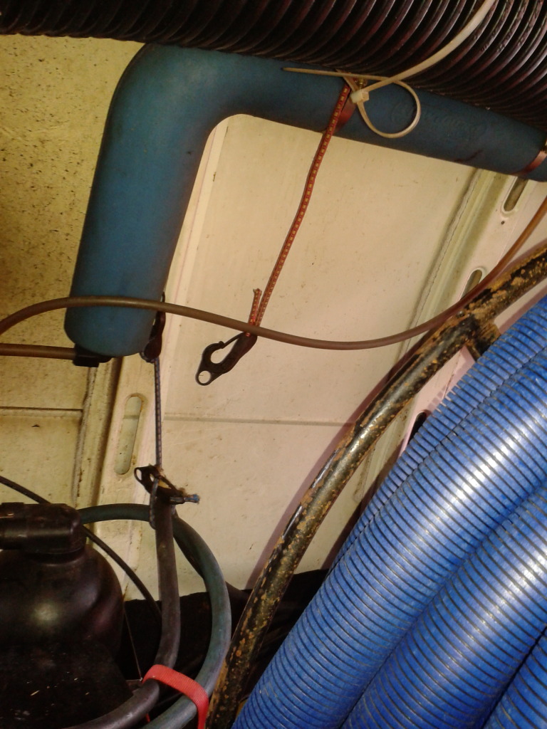

Second pic.......big plastic "L" is the brine reciever, which runs directly to the waste tank.
