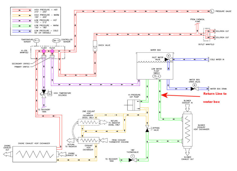

Check the return line from the regulator in the mix tank; it could be causing more turbulence on the low water switch when on high. The hose may need to be pointed in a slightly different direction; also make sure the switch is not loose.

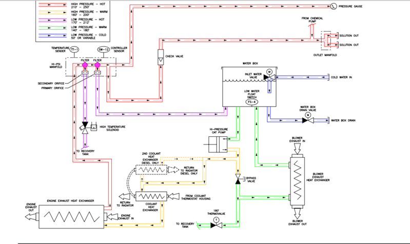

Can you tell me what line you're referring to on this picture.
Pretty sure Doyle means this one. Hopefully by now you've solved the problem?
Doyle was suggesting that water coming back into the water box could be moving the low water switch around and signaling low water when it's actually ok. The assumption is that you have looked and the water level in the box is fine, that it's not actually dropping too low. That would be a whole 'nother issue.
