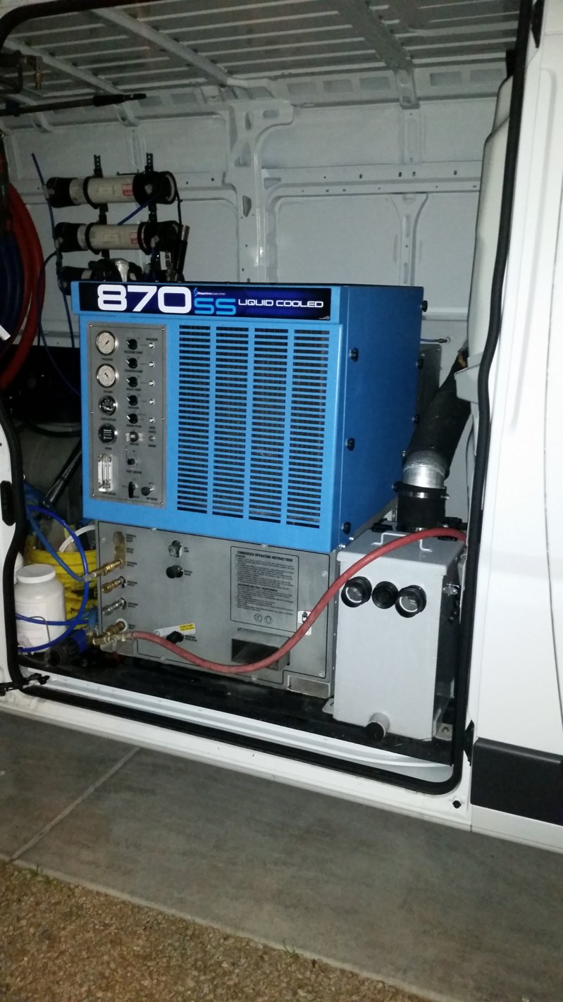

Lance Golden
Oct 24, 2007
257
Surprise, Az
Lance Golden
Gene I always run a 3 stage prefltration before RO , Pleated, a carbon block, a sediment filter prior to RO.
The carbon removes the chlorine.

Lance Golden
Oct 24, 2007
257
Surprise, Az
Lance Golden
A part of my system is in the back on the wall @GeneMiller
