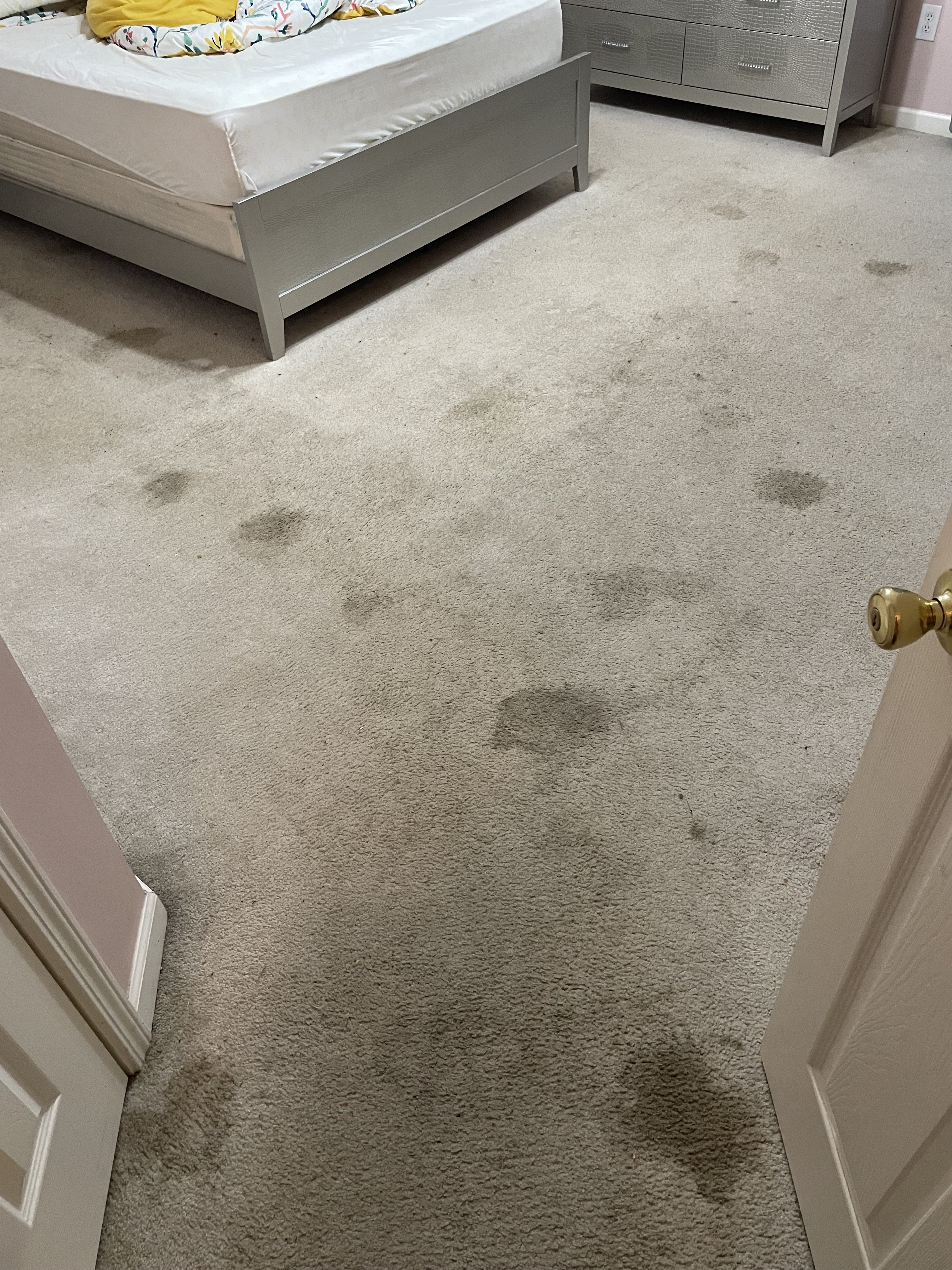

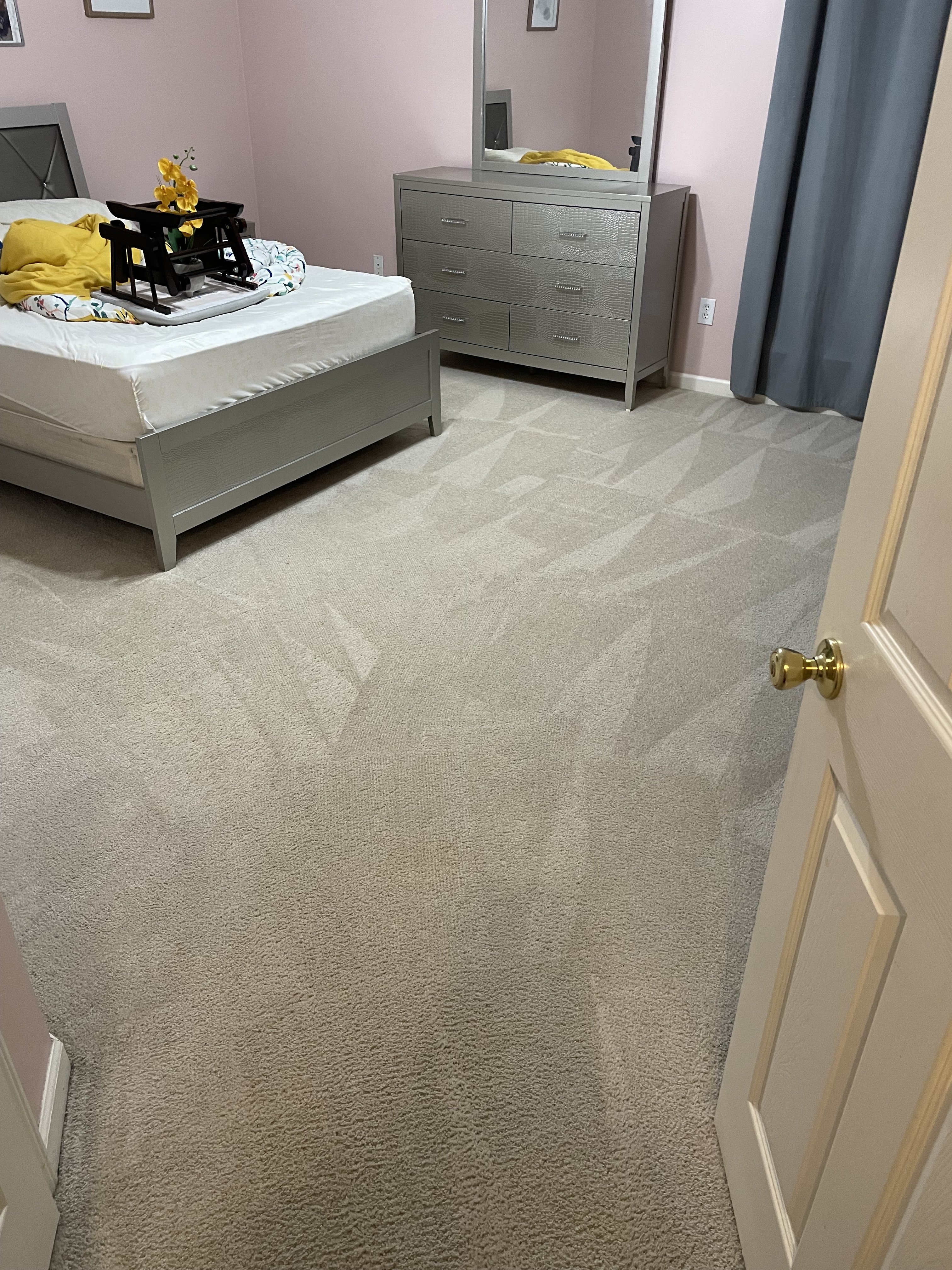

“These spots just reappeared after it was cleaned!” (18 months ago)
Kinna creepyalligator skin dresser ..
Larry, you said it was bad wand technique
So, if it wasn't the dog, who was it?“These spots just reappeared after it was cleaned!” (18 months ago)View attachment 124179View attachment 124180

rotovac and wanding is triple the flooding. Of course it wicked back. You made the pad damp. Dump that rotovac and up the flow on your wand.Larry, and that other idiot that I have on board ignore aren’t aware. Besides, I Rotovac’d it first and then wanded it.
I mean this is the kindest way possible-- But you may be wrong.rotovac and wanding is triple the flooding. Of course it wicked back. You made the pad damp. Dump that rotovac and up the flow on your wand.

Next time, try pulling back on a wet pass over the urine spots to do a plain rinse before treating the carpet. Do a dry pass, then treat the carpet. You’ll get fewer/no callbacks.Never argue with an idiot PJ

And they moved too!!had a customer have me clean her LR prior to a party. Two weeks later all these spots suddenly appeared. hmmm
