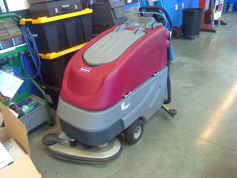

What can you Janitors tell me about this machine?
117,366
I have a Auto Dealership that bought one to maintain their new tile floors.
Will it work on grout that's normally recessed?

for the most part yea..
lets see the pics of the floor...
track down a pair of the bassine brushes for it...the brushes well get in better then a pad...
what else you wanna know?
yes it will do fine, but like floor guy said you need to get some brushes instead of the pads.
