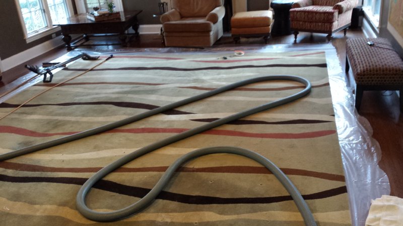

For us it has to be using disposable plastic as tarps to clean rugs on site. Mike did a call YEARS ago about this and we have been using it sense.
http://www.homedepot.com/p/Husky-10-ft-x-100-ft-6-mil-Clear-Plastic-Sheeting-CF0610C/206800024
We used to take most rugs with us, the wife is much happier now!:biggrin:

I tried the plastic under rugs and it was a pain in the ass for me, or do you put it under after the rug is cleaned? My wand would just keep sucking up the plastic pissing me off..

Keith, after placing the plastic sheet under, I fold excess under rug, clean, wipe the moisture from wood and pull the plastic out shortly thereafter. A little of a hassle but I price it in.
That way you don't have to deal with the plastic being sucked in by the wand, which is a pain.

Getting thicker plastic can also help. The super thin stuff rips and make a horrible sound when the wand hits it.

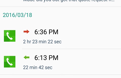

Everyone my phone sez MIKEY....I get all an" warm & fuzzy feelings.....then a DREAD of doom.....
Wtf have I done now
