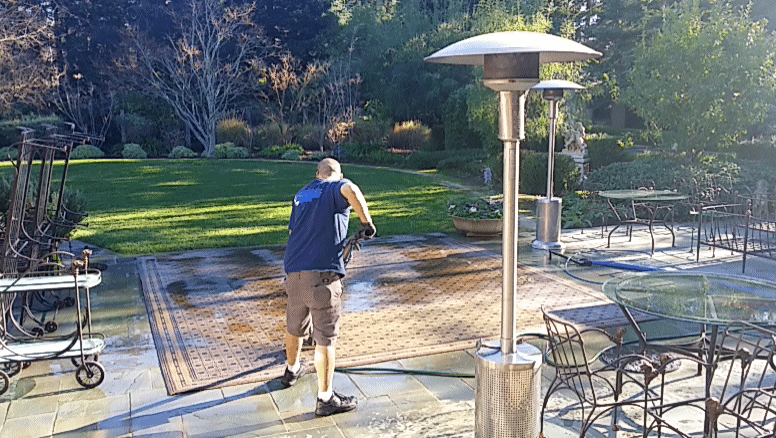

Ely and I went one a fatty up in Atherton today.
11.5 million according to Zillow.
Yet too cheap to buy a doggy door.

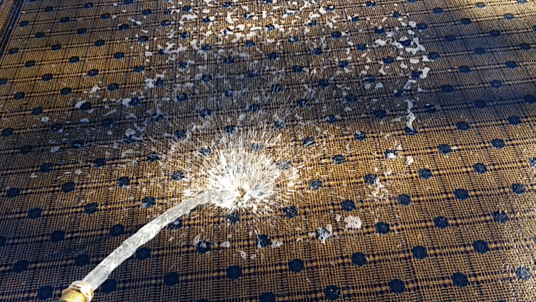

15 by 17 machine made wool and the skirts on some very high end upholstery was SOAKED in Snickerpoodle juice..
The house manager did not want to send it out due to the FACT that Snickers will continue to pee and the rug is too worn for $6.00 a foot washing...
So for a mere $3.00 a foot we dragged it out side and did our best Randy Hyde impersonation..
Lots of uph too.
We'll be delivering fresh pad and picking up fans on Monday
Went home soaked in piss, very much needing a shower..

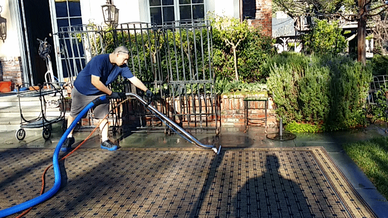

The CEO of house management could not get a hold of the owner so just gave us her blessing to do what we felt was best.
We laid out plastic on the lR floor and brought the rug back in after extracting it real well. It's a very thin machine made so we got it dryer than Willy would have left it.
Placed a Snail under it and an Airpath on top.
Ely got a valuable lesson on just how much it takes to really get urine out of a rug. It was his first time seeing such a thing.
$2300 for everything.

I wasn't sure by looking at the picture: Was there a backing glued on to give it extra dimensional stability?
I'm surprised it did not buckle on location due to the jute core expanding while wet and putting tension on the woven fiber. And yes, it practically takes forever to get most of the urine out of a soaked rug.

Mikey that is 3/4 yd wilton carpet. Being handsewed helped alot from fooken it up. It has alot of jute not poly wefts. I see the way you flooded was good uneven can cause alot of bubbling. The seams were off by the sewer but it looks like he sewed it with equal tension . Be careful and you see that that is like a 100 a linear ft and could be more.
Harry Myers
Oct 13, 2007
1,268
Harry Myers
Hey it worked I do it to but you did a good job on it. From what I seen but those are never polypropylene weft always jute. I do immerse mine for a equal flooding .
