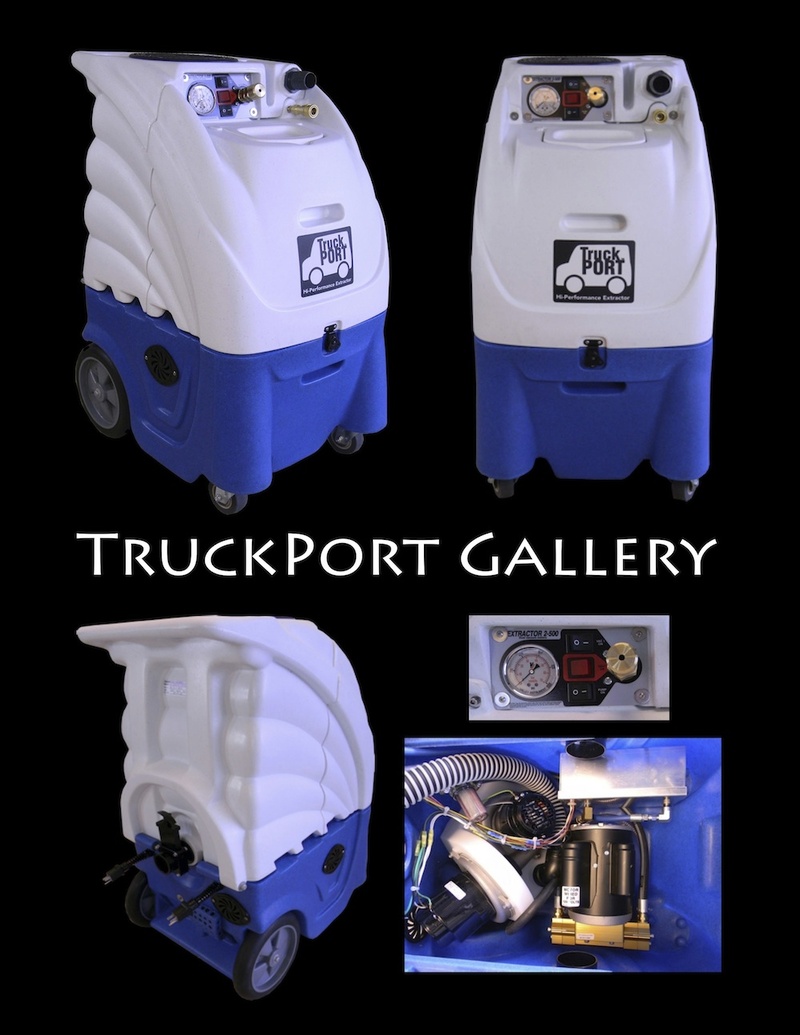

I'll say it again... You guys really should check out our TruckPort. Why?
It is built for us by Sandia. They've been building solid extractors for years - so the quality is there.
And it is priced very well - considering what it offers!!!
Key Features of the TruckPort:
* High Pressure Adjustable 500 PSI Pump
* Dual 2 Stage Air Watt 6.6 HiFlow Vacuum Motors Producing 200" of Waterlift
* 2000 Watt Heater for On-Demand Heat
* 12 Gallon Solution & Recovery Tanks
* 10" Non-Marking Rear Wheels
* Lid Design Holds 2 Spray Bottles
* 25' Power Cords
On Sale For $1999 (With FREE Shipping to a Commercial Address)
The vac configuration producing 200" of water lift is very high! High CFM is important for the long hose runs of a truck mount - but with a porty it's important to have high water lift. Another benefit that comes from using the dual 2 stage motors is that it reduces the amount of current draw. Yet the air watt vac motors produce tremendous suction. It's a setup that works!
We've also put a lot of thought into the name and the logo. It's prominently displayed on the front of the machine. We're not trying to say this is a truckmount replacement. But it does help to have a picture of a truck on the logo and to have the name TruckPort displayed to your customers. It conveys power to your customer.
Have a look:

It sounds like a good machine and a good price Rick.
However, regardless of your emotions, you don't really get it.
Unfortunately, there is no one fit all machine. I am sure that you as a seller and the manufacturers, do your math and decide which market it is you want to serve.
As an owner operator that uses a portable occasionally, and a lot more than I'd like to, I'd like to take the time and tell you what it is that your machine lacks. If it is worth it for you or any other seller, if it is profitable for you. maybe you'd do something about it.
Yea, yea, I know, they all suck and squirt.
Here it goes:
  1. Take the heater out. Don't want it inside an already over crowded over heated machine.
  2. If you feel like filling out the space, give me the new stronger vac motors.
  3. The lid with spray bottle holder is cute. Get rid of it. Make a machine with a flat top and the ability to attach a box (hell, sell me the box) that I can carry all my staff safely and secured.
  4. Add an attachment to carry the wand. You know- we use it to clean- it squirts and it sucks. Help us out by making it easy to wheel it in, all together. Thank you.
  5. Add a wheel at top to allow me to load it easily in and out of the van, by myself, without a trip to the chiropractor.
  6. Is that an inch and a half hose cuff? If it is, you got to be kidding. That is Frank & Willy territory. We carry it in a van that has a truck mount. We use truck mount hoses.
  7. Use wheels with some give to allow for inside components protection from the constant rattling that wears the metal fittings. And not inflatable, it will get punctured. I ain't going to take it to have the flat tire of my portable fixed. Are you aware of what it will do to my self image? I do have some pride left.
  8. As per inside placement and components? Don't know. Can't see from your pictures. Are you using stainless steel fittings? Quality components? Is it getting blazing hot inside? Or if you don't know- If I left a strip of bacon inside, how long till its done?
  9. Is there a fan to cool inside components (not sure if it will help.)
  10. Is there a circuit indicator?
  11. For crikey's sake don't make a white machine. We don't date it. What are the chances it will stay white in the van? Make it scratch grey or invincible black complete with pre made white scratches.
And if you have to slap a few extra $$$ to make that. Good. You've earned it.

Ofer if you want 2" vac hoses, we have an adapter for that. Most portable guys will opt for working with lighter 1.5" hoses. But like I say, if anyone wants a 2" hose bib - we have it. And there's no extra charge for the adapter.
Yes, the TruckPort has a built in circuit indicator. Regarding the running temperature, the machine is well vented - it gets pretty warm but not extremely hot.
I really appreciate all the thought you put into your list of suggestions. I'm not sure how feasible some of it would be to implement, but I like your ideas :)
The white is a speckled granite white, you can't really see that from that photo. It camouflages scratches and soil pretty well.
And of course, if you don't want to run the heater, you can always turn off the heater switch. Yet it's nice to have the option if you want to use heat.

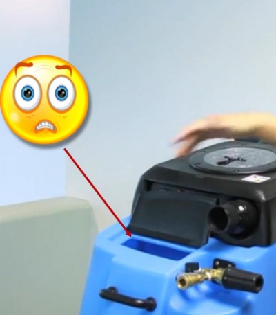

Man I hate those small openings! :icon_neutral:
Makes it a chore to pour in water with a 5-gallon bucket.

Yes, Richard is right- bigger openings for water.
