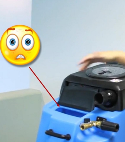

What is the best.......(dare I say)...... portable??!!
Fill hose would be great for Janitors closets but still more narrow than I prefer in a home or apartment.
Frank sorry I prefer a 5-gallon pail.....not a big gulp cup.:winky:

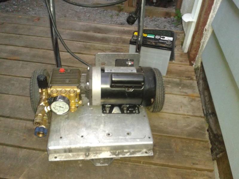

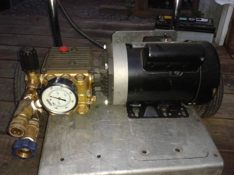

You won't like this Ofer, but here's the very best brand of pump I've ever used. 5 years of heavy use with no grief. I'd love to team this up with a pair of those 8.4 vacs. Next up is to get a pair of big stainless pots, build a base to hold the vacs. Yep - it's gonna look hokey,require 3 cords, heavy and awkward, but it'll beat the boogers out of most machines on the market. I bought that pump from Mr. Cobb years ago.
The problem I've had and seen with most machines available is planned obsolescence.Proprietary parts that fail prematurely. You're bent over and there isn't any "lube".

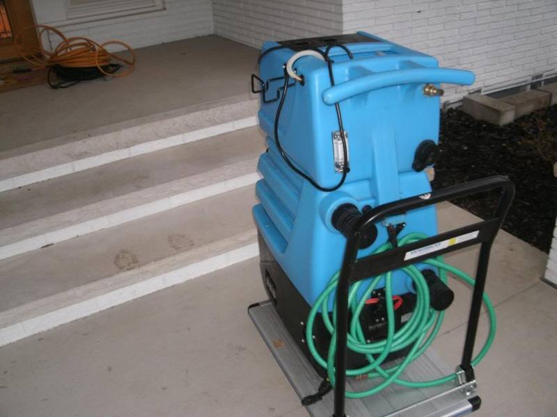

I really think you use the Mytee AirHog Plus/Waterbox. It has all the vac you can get from 2 15 amp circuits and the waterbox is a low amp 220 psi diaphragm pump. The design and build have some annoying flaws, particularly the stupid little wheels make it unstable and it will tip over (with the waterbox full of water LOL) but it has great potential. I took off the wheels and put it on a nifty cart. It's modular so nothing is too heavy for even a wimpy person to lift out of the vehicle. Autofill/autodump so you operate it as if you have a TM with a 33 blower next to the door.

I've thought about this one. What do you think about the 200 psi though?

The 220 psi pump is fine if you precondition the carpets with a HF and a 175 or run a rotary extractor. It works well for me and I'm sure you could make it work well. I do much of my work with the 90-100 psi hot water from a faucet without the use of the Waterbox, which I haven't used for a long time. I've been using a dual 3 stage CFX which does the same thing as an Air Hog Plus but weighs even less.

But Willy . . . you didn't tell them about the fire it also survived during those FIVE YEARS.
General Pumps . . . used on the best TM's nad Escape Electric TMs.
It will also fit in the Mytee 1006 portable with a 3/4 HP AC motor for cleaning Carpet @ 600 PSI and T&G @ 750 PSI.

<!--[if gte mso 9]><xml> <o:OfficeDocumentSettings> <o:AllowPNG/> </o:OfficeDocumentSettings> </xml><![endif]--> Don't do it Will-i-am! You've got completely hackish man.
While it may work, its gonna look like you stepped back into the 70's. Don't be THAT guy!
