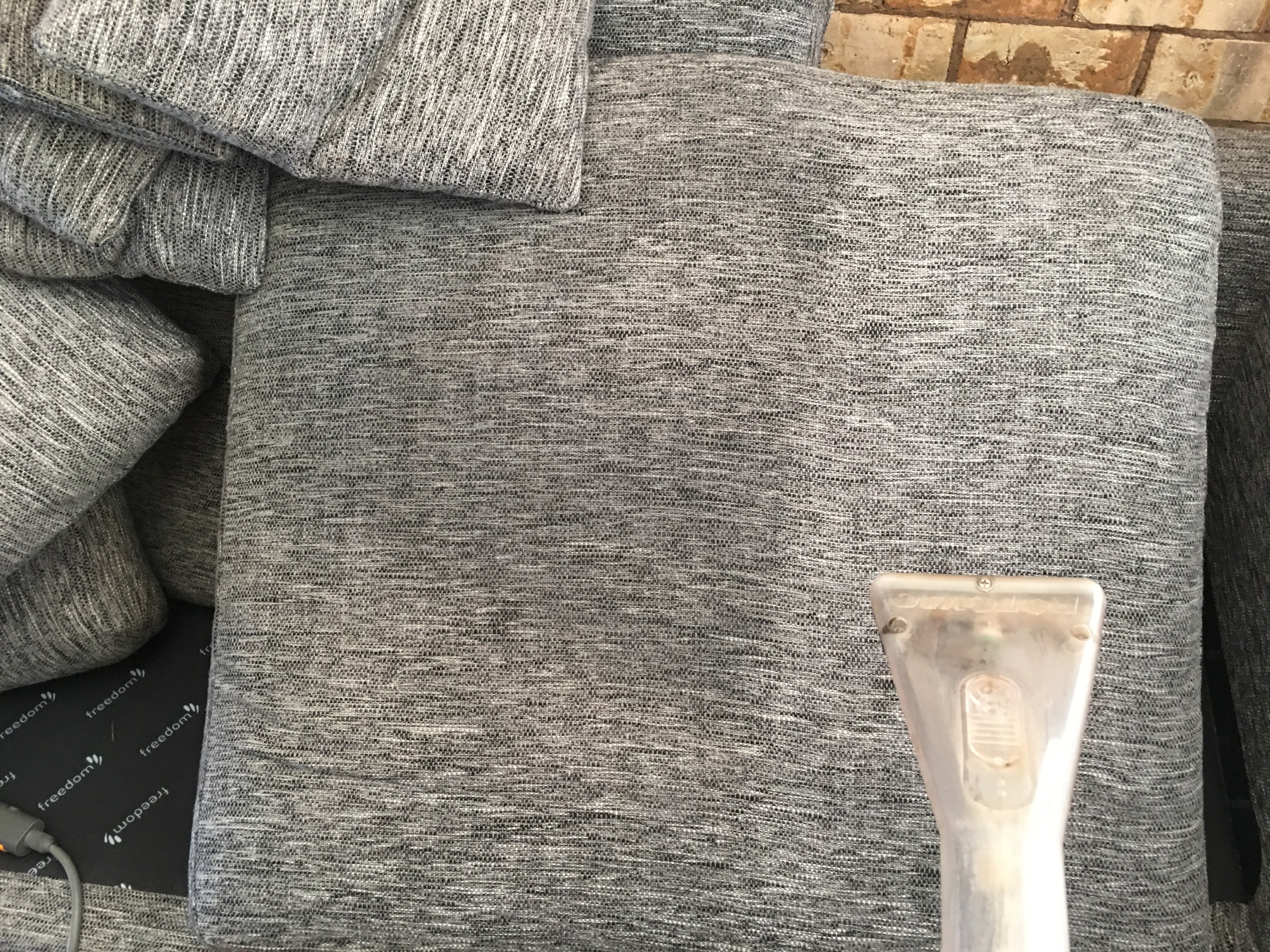

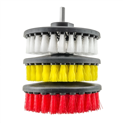

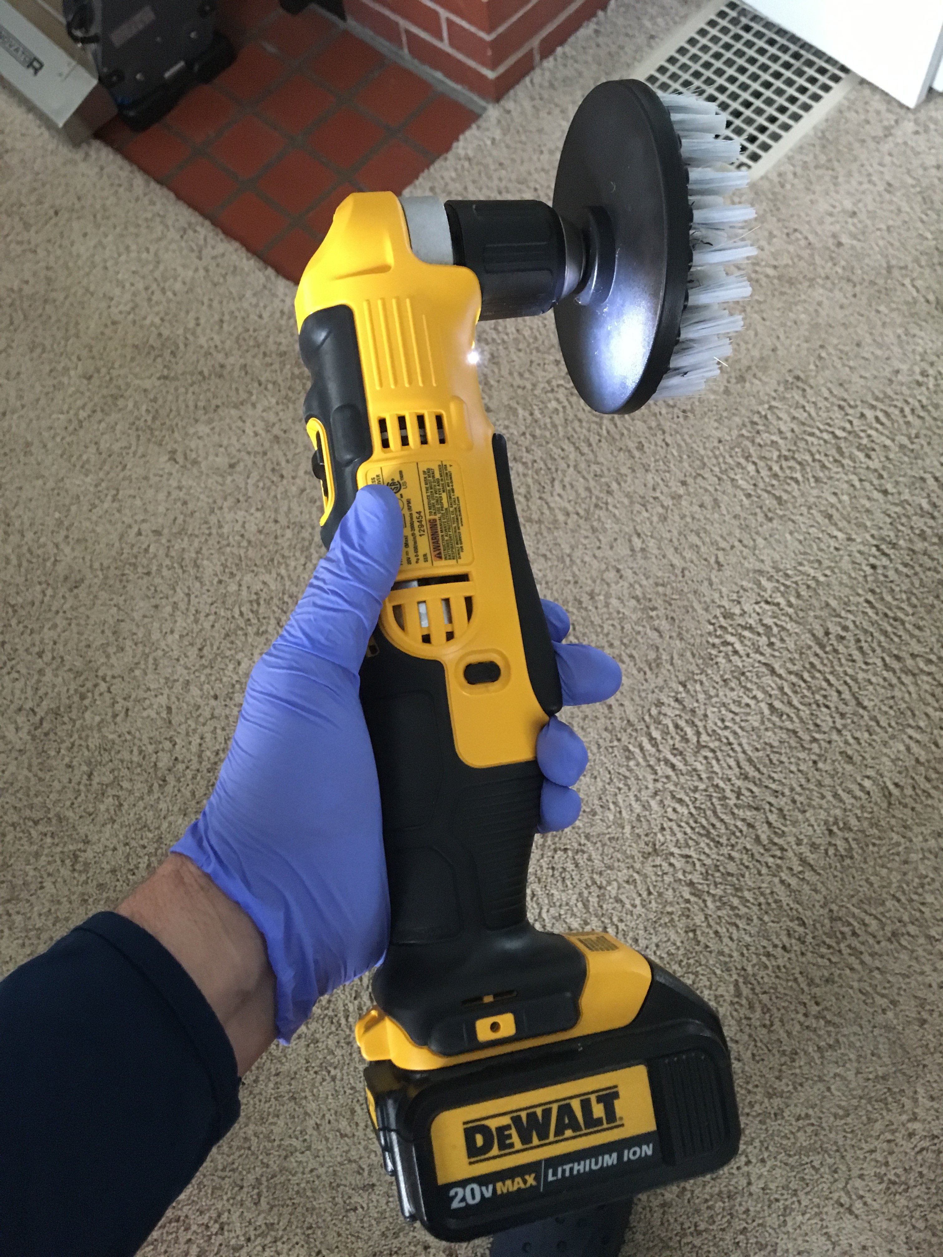

Another cool upholstery scrubbing method I recently discovered is to use Sea Sponges - if you want a super low moisture approach. A natural Sea Sponge (not a synthetic sponge) will produce copious amounts of thick foam, so you can clean the fabric using minimal moisture. Simply mix some encap detergent in a bucket. Dip the Sea Sponge into the bucket. Wring it out tightly. It'll be practically dry with a thick lather of foam. Then wipe the surface of the piece you're cleaning. It's useful for delicate pieces. But for the dirty chair in the picture, you'll like want to use something like the drill brush above.
