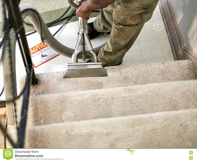

Nov 21, 2016 #3 R roro Member Joined Oct 18, 2006 Messages 1,226 Location Wellington Name Ross Craig Does the twin neck give better airflow? roro
Nov 21, 2016 #4 Mikey P Administrator Joined Oct 6, 2006 Messages 113,816 Location The High Chapperal Doubtful, just confuses the flow Reactions: Shorty and BIG WOOD
Nov 21, 2016 #5 Cleanworks Moderator Joined Oct 22, 2012 Messages 27,302 Location New Westminster,BC Name Ron Marriott But it looks cool. Can you imagine if it swiveled?
Nov 21, 2016 #6 BIG WOOD The Timminator Joined Feb 4, 2016 Messages 13,559 Location Georgia Name Matt w. Mikey P said: Doubtful, just confuses the flow Click to expand... That's the reason I'm considering going from 2, 2" hoses to the door, down to just a single 2.5" vac hose to the door.

Nov 21, 2016 #7 Jimmy L Member Joined Oct 7, 2006 Messages 15,209 Location Ne Name Jimmy L I had 50 feet of 2.5 hose on my reel. Too stiff and cumbersome so after 3 years I went back to all two inch. Reactions: BIG WOOD, Pioneer Floorcare, Shorty and 1 other person

Nov 21, 2016 #8 Doug Rice Supportive Member Joined Feb 28, 2011 Messages 425 You might have a point on that airflow thing. I have 2 2" hoses coming off my waste tank to a Y and then to 2.5" hose. One of the filters in my waste tank always has two to three times as much junk in is as the other filter? Reactions: Mikey P and BIG WOOD

Nov 22, 2016 #9 R roro Member Joined Oct 18, 2006 Messages 1,226 Location Wellington Name Ross Craig We run about 50' of 2.5" to our filter box then a single 2" from there ( or double 2" if -2- wands going.) Maybe our filter box has confused air roro Reactions: Mikey P
