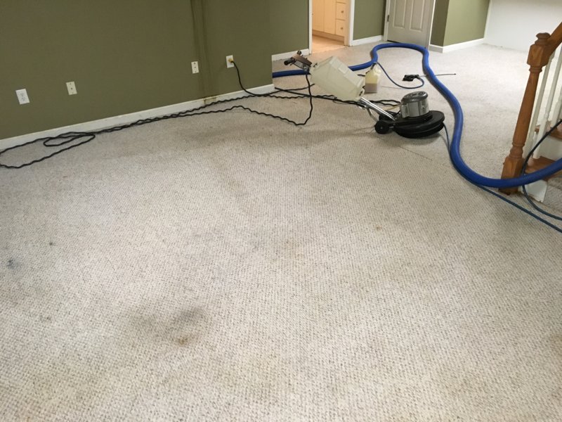

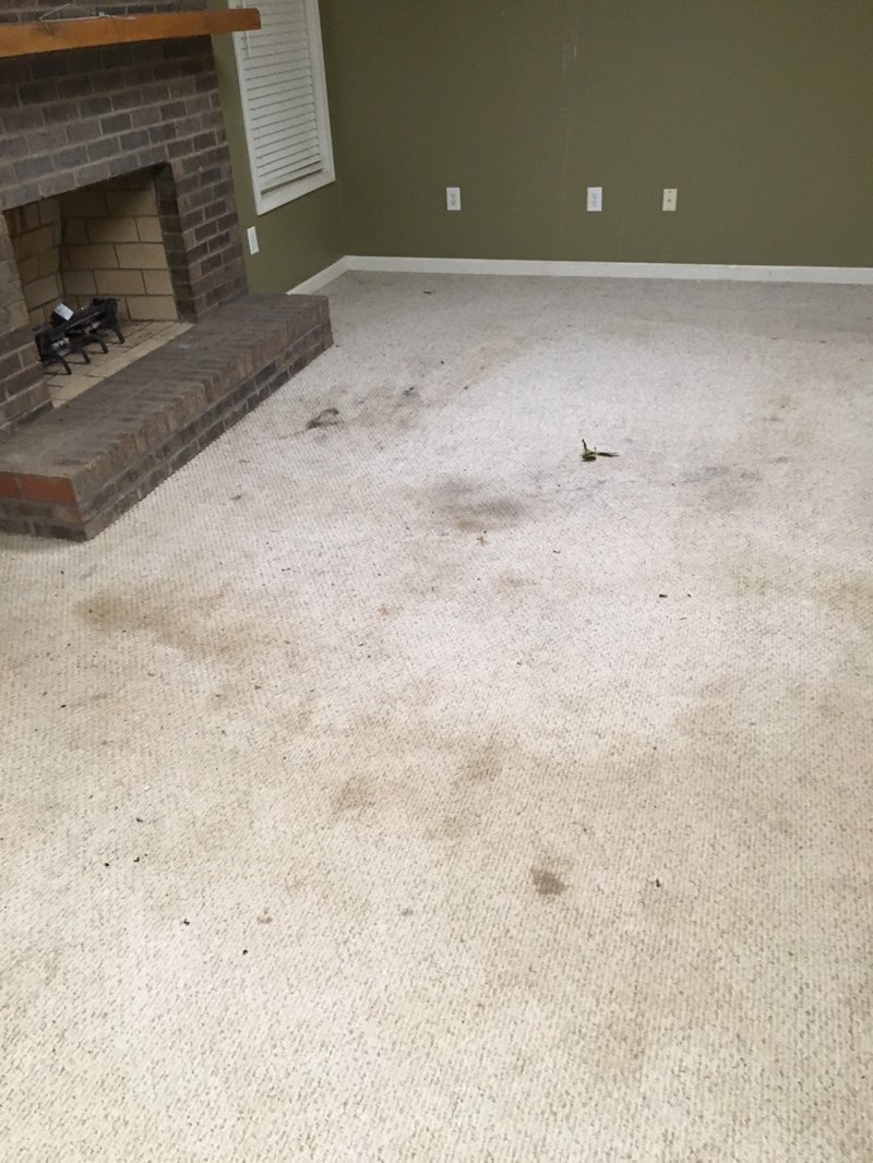

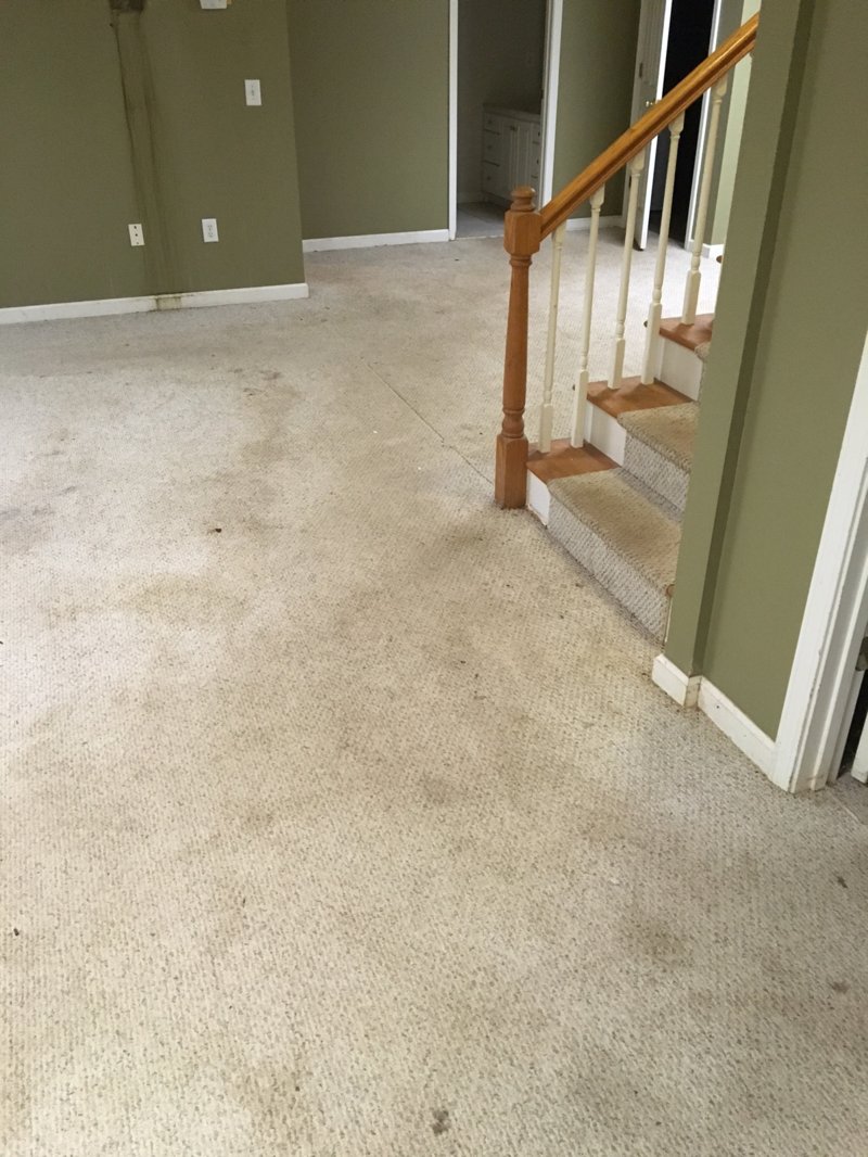

on trashed Berber. I've never used my new CRB on Berber yet. Will that do better than a 175 with a red pad or brush?
I'll try to send the pics that my customers sent me on here
14,641
Here's a little bit of my job tomorrow. This house was vandalized

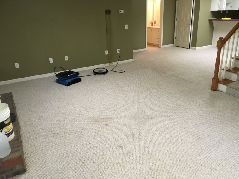

175 with a brush before/after

Yeah, it was a 4hr job on this vandalized, water damage stained carpet. I did the best I could with firestorm and peroxide pre sprayed. They were very happy with the outcome of it.
