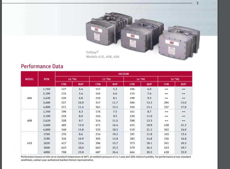

Is that agitation is king.
All three of these blowers will be on the Sapphire Demo truck.
All of them will give different readings with the CFM meter I'm bringing, yet all of them will the 406 will clean exactly the same at the 410 at 150 ft.
All these theories and debates on inches of lift and cubic feet measures are based on Scrub Wand technology.
