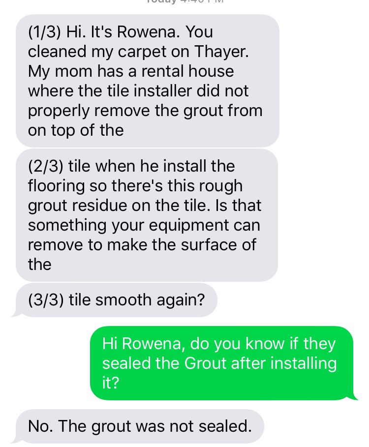

See text message below from customer.

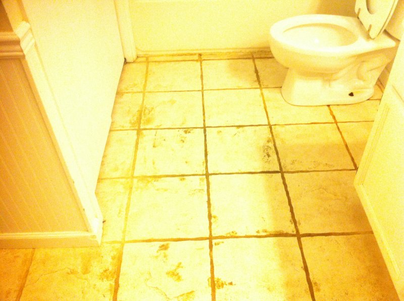

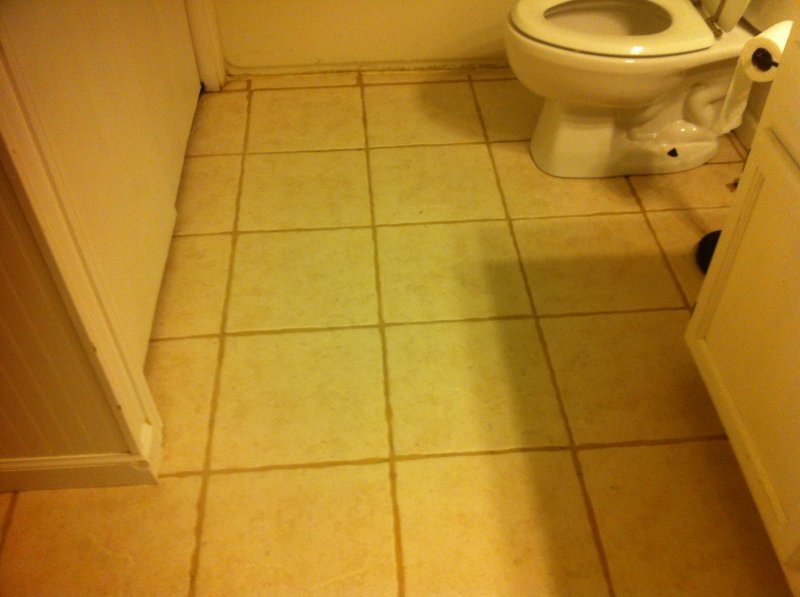

The tile installer will not call them back anymore. Rough residue on the tile. She is saying it is grout residue but I am not sure. I asked for pictures, she didn't have any. Asked me to stop by the empty house and look at it when we had time. Any ideas on what this maybe or suggestions I can give to her? Or something we can do?

Will, removing cementatious grout is easy, but do NOT use muriatic acid.
Go get Viper Renew from your Interlink supplier, or a non-fuming concrete brightener/etcher from your local chemical pimp. Dab it on the tile with a sponge, let it fizz and soften and periodically poke it with a plastic scraper to help break it up.
Ventilate well
Use a wet vac or your hard surface wand to suck it up, repeat as needed. At the end, slosh something alkaline to neutralize things, rinse and there you are.
You can get rid of some real crusty slops that way. However if he used an epoxy grout, you need to use acetone, and good ventilation.
How to tell the diff? Drop acid and if it foams it is cement.
