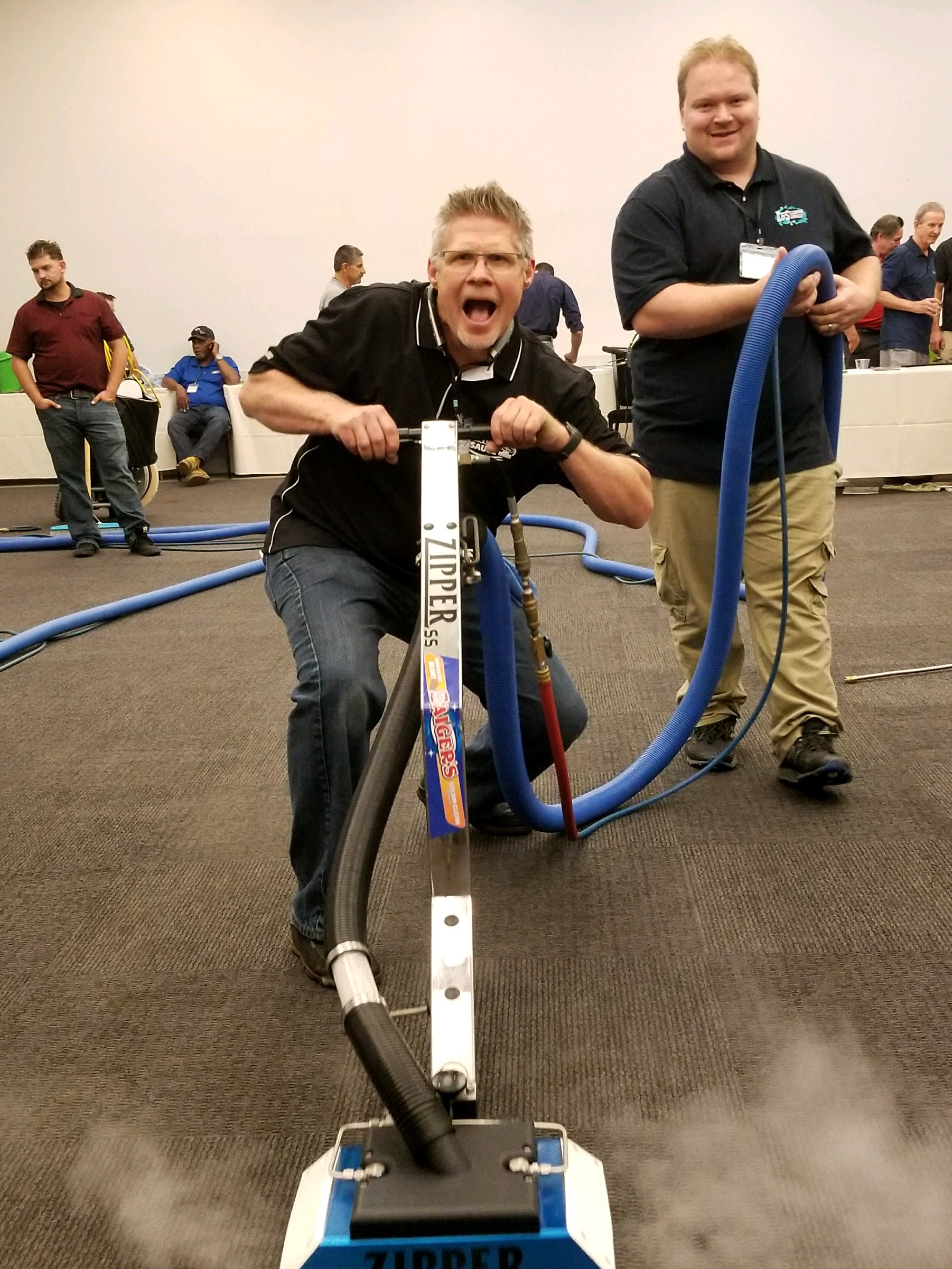

You have max heat and good suck. I'd do a ZIPPER SPINNER.
No power cords, You'll be cutting through soil like a hot knife through butter.
