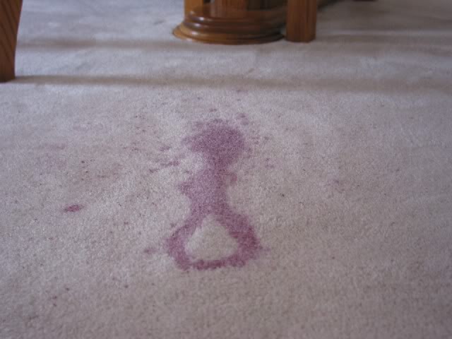

Before and after Wine stain -

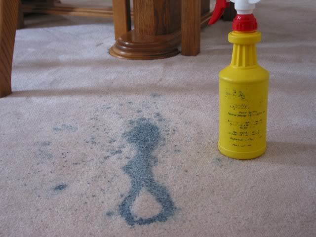

Next some Ammonia was sprayed onto the stain. If the customer is watching, tell them that it will turn green - they will be impressed though who knows why.

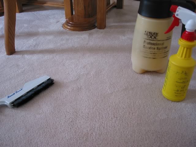

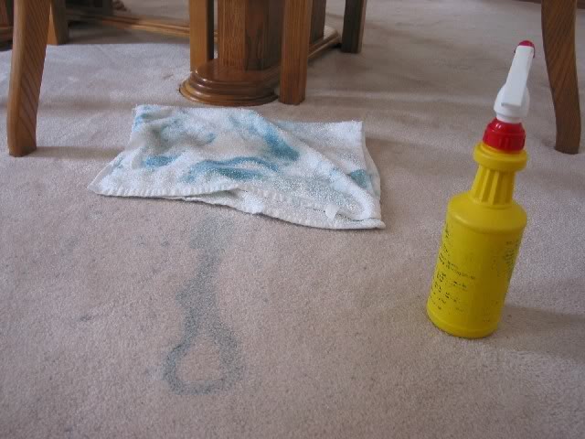

Towel off, re-spray with ammonia and add equal amount of Hydrogen Peroxide.
Give it a few minutes a and then towel off. If the stain is still visible, repeat the process and if that does not do the trick apply some steam.

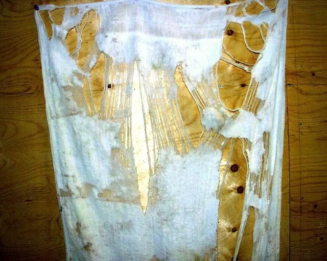

What happens to a cotton towel when Peroxide is used onto it.

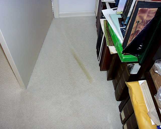

What happens when you clean around a door that rubs on the carpet.
